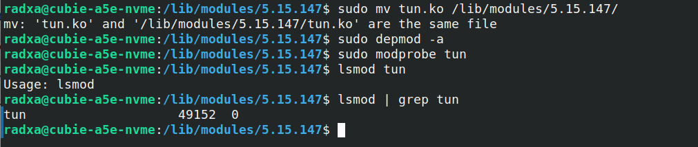

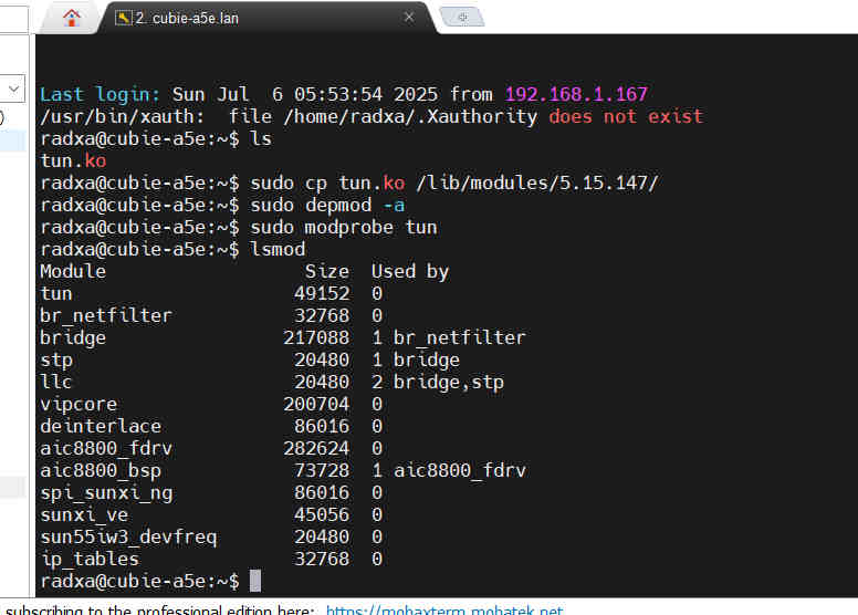

Anyway, the provided tun.ko is working. I can now finish switching my router from X86 to Cubie A5E.
