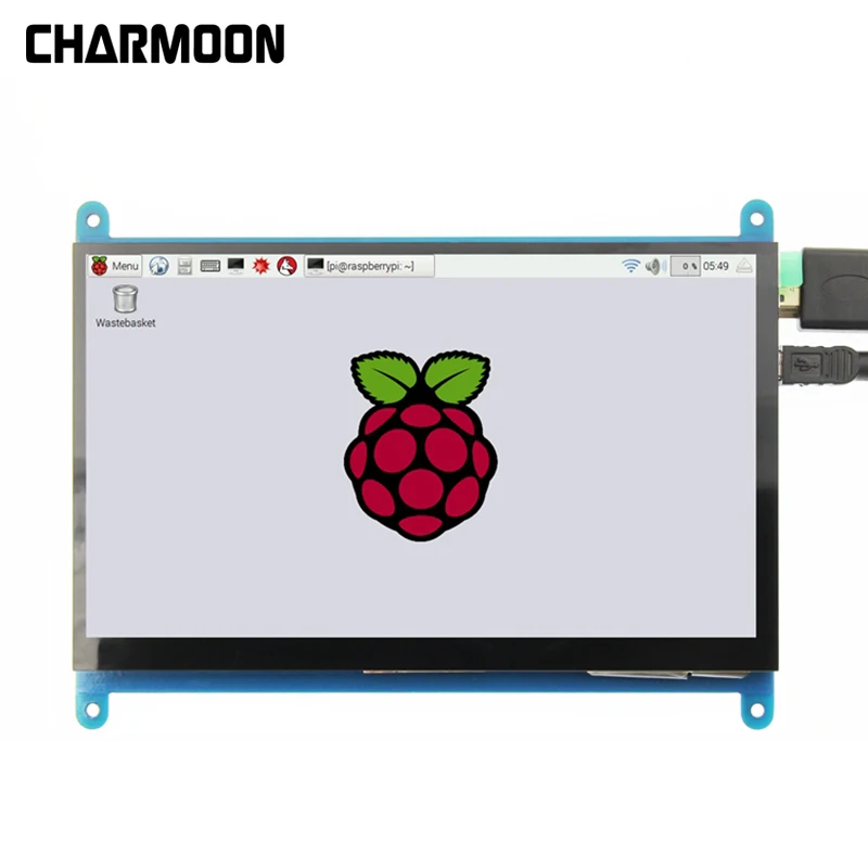

I use this display and it works. I am using the NanoPi M4 right now with it and it works. Just tried it.
https://www.aliexpress.com/item/For-Raspberry-pi-7inch-HDMI-LCD-Capacitive-5-Point-Touch-Screen-Display-1024-600-High-Resolution/32886565683.html?spm=2114.search0104.3.8.2cb9353dRcX4Gj&ws_ab_test=searchweb0_0,searchweb201602_1_10065_10068_319_317_10696_10084_453_10083_454_10618_10304_10307_10820_10821_537_10302_536_10843_10059_10884_10887_321_322_10103,searchweb201603_35,ppcSwitch_0&algo_expid=3eb7bc24-67c4-42b7-89b1-82b7ef1367fc-1&algo_pvid=3eb7bc24-67c4-42b7-89b1-82b7ef1367fc
You can find them cheaper. But it’s the one with 2 microUSB ports that’s best.
I’ve had an original Waveshare 7" 1024x600 display and the microUSB port broke off after a few weeks.
I’ve been using this one for +2 years now, I take it with me when traveling. It’s always done a great job.
Those RPI displays are way overpriced. It’s the same panels they use, but just a much bigger profit.

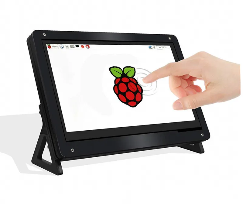

Here the cheaper one.
You can buy a case and stand with it and it’s still cheaper.
https://www.aliexpress.com/item/New-7-inch-1024x600-USB-HDMI-LCD-Display-Monitor-Capacitive-Touch-Screen-Holder-Case-For-Raspberry/32992948847.html?spm=2114.search0104.3.148.1ef24b48DRPwQf&ws_ab_test=searchweb0_0,searchweb201602_1_10065_10068_319_317_10696_10084_453_10083_454_10618_10304_10307_10820_10821_537_10302_536_10843_10059_10884_10887_321_322_10103,searchweb201603_35,ppcSwitch_0&algo_expid=2ba9412d-d26d-4238-b96a-912f5c260e3e-22&algo_pvid=2ba9412d-d26d-4238-b96a-912f5c260e3e
