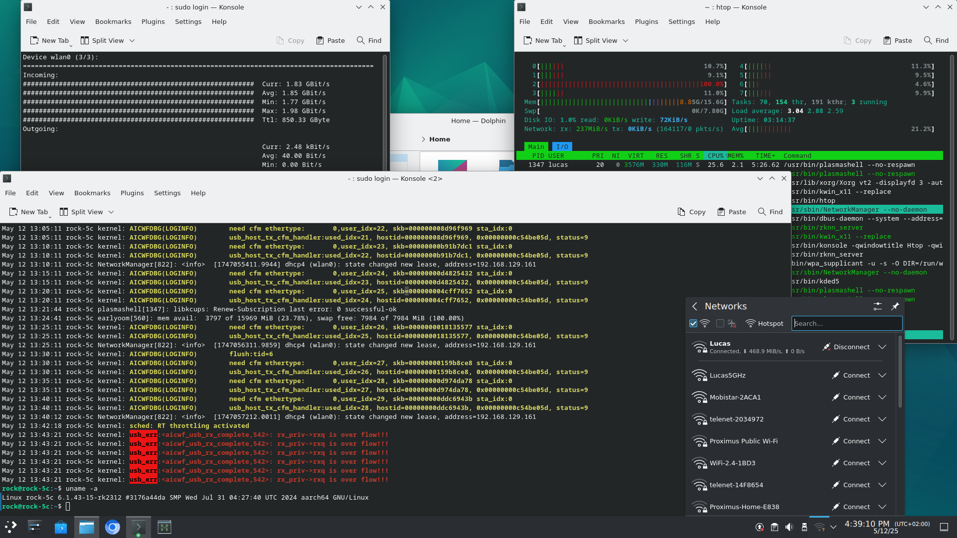

Hi, IMO the wifi of rock5c is not stable. I have tried a few days of usage as a tv box and it worked fine. But used with more intense I see kernel panics. It still not clear to me if the cause is number of connections or what. But for reliable I’m use stuck with ETH.
I’m using Armbian
rock-5c:~$ dmesg | grep -i 3561b08f
[ 44.182016] RELEASE DATE:2024_0327_3561b08f
[ 46.835432] AICWFDBG(LOGINFO) RELEASE DATE:2024_0327_3561b08f
rock-5c:~$ uname -a
Linux rock-5c 6.1.99-vendor-rk35xx #1 SMP Fri Feb 7 15:19:27 UTC 2025 aarch64 aarch64 aarch64 GNU/Linux
In these logs wifi got disconnected. I tried airplane mode on/off and it crashed the system.
journal logs
may 11 17:37:58 rock-5c systemd[1736]: Starting psd-resync.service - Timed resync…
may 11 17:37:59 rock-5c profile-sync-daemon[4090845]: chromium resync successful
may 11 17:37:59 rock-5c systemd[1736]: Finished psd-resync.service - Timed resync.
may 11 17:41:47 rock-5c systemd[1736]: Started app-gnome-gnome\x2dwifi\x2dpanel-4090906.scope - Application launched by gnome-shell.
may 11 17:41:58 rock-5c NetworkManager[1389]: [1746978118.3124] manager: rfkill: Wi-Fi hardware radio set enabled
may 11 17:41:58 rock-5c NetworkManager[1389]: [1746978118.3142] audit: op=“radio-control” arg=“wireless-enabled:on” pid=4090906 uid=1000 result=“success”
may 11 17:41:58 rock-5c NetworkManager[1389]: [1746978118.3245] manager: rfkill: Wi-Fi now enabled by radio killswitch
may 11 17:41:58 rock-5c systemd[1]: Starting systemd-rfkill.service - Load/Save RF Kill Switch Status…
may 11 17:41:58 rock-5c systemd[1]: Started systemd-rfkill.service - Load/Save RF Kill Switch Status.
may 11 17:41:58 rock-5c kernel: AICWFDBG(LOGINFO) rwnx_virtual_interface_add: 10, p2p-dev-wlan0
may 11 17:41:58 rock-5c kernel: AICWFDBG(LOGINFO) rwnx_virtual_interface_add, ifname=p2p-dev-wlan0, wdev=00000000ee6aab01, vif_idx=1
may 11 17:41:58 rock-5c kernel: AICWFDBG(LOGERROR) p2p dev addr=88 0 33 77 b7 b
may 11 17:41:58 rock-5c wpa_supplicant[1392]: nl80211: kernel reports: Registration to specific type not supported
may 11 17:41:58 rock-5c kernel: AICWFDBG(LOGINFO) P2P interface started
may 11 17:41:58 rock-5c NetworkManager[1389]: [1746978118.4569] device (wlan0): supplicant interface state: internal-starting -> disconnected
may 11 17:41:58 rock-5c NetworkManager[1389]: [1746978118.4590] device (p2p-dev-wlan0): state change: unavailable -> unmanaged (reason ‘removed’, sys-iface-state: ‘removed’)
may 11 17:41:58 rock-5c NetworkManager[1389]: [1746978118.4604] Wi-Fi P2P device controlled by interface wlan0 created
may 11 17:41:58 rock-5c NetworkManager[1389]: [1746978118.4611] manager: (p2p-dev-wlan0): new 802.11 Wi-Fi P2P device (/org/freedesktop/NetworkManager/Devices/6)
may 11 17:41:58 rock-5c NetworkManager[1389]: [1746978118.4617] device (p2p-dev-wlan0): state change: unmanaged -> unavailable (reason ‘managed’, sys-iface-state: ‘external’)
may 11 17:41:58 rock-5c NetworkManager[1389]: [1746978118.4628] device (wlan0): state change: unavailable -> disconnected (reason ‘supplicant-available’, sys-iface-state: ‘managed’)
may 11 17:41:58 rock-5c NetworkManager[1389]: [1746978118.4640] device (p2p-dev-wlan0): state change: unavailable -> disconnected (reason ‘none’, sys-iface-state: ‘managed’)
may 11 17:41:59 rock-5c wpa_supplicant[1392]: wlan0: Reject scan trigger since one is already pending
may 11 17:42:00 rock-5c NetworkManager[1389]: [1746978120.4675] policy: auto-activating connection ‘Lucas’ (1d35b87c-1558-421e-b20e-60119c530e82)
may 11 17:42:00 rock-5c NetworkManager[1389]: [1746978120.4691] device (wlan0): Activation: starting connection ‘Lucas’ (1d35b87c-1558-421e-b20e-60119c530e82)
may 11 17:42:00 rock-5c NetworkManager[1389]: [1746978120.4693] device (wlan0): state change: disconnected -> prepare (reason ‘none’, sys-iface-state: ‘managed’)
may 11 17:42:00 rock-5c NetworkManager[1389]: [1746978120.4704] device (wlan0): state change: prepare -> config (reason ‘none’, sys-iface-state: ‘managed’)
may 11 17:42:00 rock-5c NetworkManager[1389]: [1746978120.4756] device (wlan0): Activation: (wifi) access point ‘Lucas’ has security, but secrets are required.
may 11 17:42:00 rock-5c NetworkManager[1389]: [1746978120.4757] device (wlan0): state change: config -> need-auth (reason ‘none’, sys-iface-state: ‘managed’)
may 11 17:42:00 rock-5c NetworkManager[1389]: [1746978120.4763] sup-iface[51ceed806527a634,2,wlan0]: wps: type pbc start…
may 11 17:42:00 rock-5c wpa_supplicant[1392]: wlan0: WPS-PBC-ACTIVE
may 11 17:42:00 rock-5c NetworkManager[1389]: [1746978120.4994] device (wlan0): supplicant interface state: disconnected -> scanning
may 11 17:42:00 rock-5c NetworkManager[1389]: [1746978120.4995] device (p2p-dev-wlan0): supplicant management interface state: disconnected -> scanning
may 11 17:42:00 rock-5c NetworkManager[1389]: [1746978120.5016] device (wlan0): state change: need-auth -> prepare (reason ‘none’, sys-iface-state: ‘managed’)
may 11 17:42:00 rock-5c NetworkManager[1389]: [1746978120.5026] device (wlan0): state change: prepare -> config (reason ‘none’, sys-iface-state: ‘managed’)
may 11 17:42:00 rock-5c NetworkManager[1389]: [1746978120.5034] device (wlan0): Activation: (wifi) connection ‘Lucas’ has security, and secrets exist. No new secrets needed.
may 11 17:42:00 rock-5c NetworkManager[1389]: [1746978120.5035] Config: added ‘ssid’ value ‘Lucas’
may 11 17:42:00 rock-5c NetworkManager[1389]: [1746978120.5036] Config: added ‘scan_ssid’ value ‘1’
may 11 17:42:00 rock-5c NetworkManager[1389]: [1746978120.5036] Config: added ‘bgscan’ value ‘simple:30:-70:86400’
may 11 17:42:00 rock-5c NetworkManager[1389]: [1746978120.5037] Config: added ‘key_mgmt’ value ‘WPA-PSK WPA-PSK-SHA256 FT-PSK’
may 11 17:42:00 rock-5c NetworkManager[1389]: [1746978120.5037] Config: added ‘auth_alg’ value ‘OPEN’
may 11 17:42:00 rock-5c wpa_supplicant[1392]: wlan0: WPS-CANCEL
may 11 17:42:00 rock-5c NetworkManager[1389]: [1746978120.5037] Config: added ‘psk’ value ‘’
may 11 17:42:00 rock-5c wpa_supplicant[1392]: wlan0: Trying to associate with 30:67:a1:d9:45:d4 (SSID=‘Lucas’ freq=2437 MHz)
may 11 17:42:00 rock-5c kernel: AICWFDBG(LOGINFO) rwnx_send_sm_connect_req drv_vif_index:0 connect to Lucas(5) channel:2437 auth_type:0

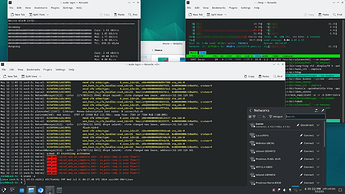

My use case is Nimbus+Geth in Holesky network. With ethernet it works for days without issue even from genesis. But with Wi-Fi after a couple of hours I always get some kind of crash or weird behavior.
Using
ROCK 5C Desktop System Image: Debian12 KDE b1
I catched a usb_err overflow errors, I get the same with Armbian in any release. Trying to reconnect or restart leads to kernel panic:
And it’s 2.4Ghz Wi-Fi and Bluetooth disabled.
journalcrt begining of AICWFDBG errors

May 12 12:23:24 rock-5c plasmashell[1347]: libkcups: Renew-Subscription last error: 0 successful-ok
May 12 12:24:40 rock-5c earlyoom[560]: mem avail: 8696 of 15969 MiB (54.46%), swap free: 7984 of 7984 MiB (100.00%)
May 12 12:25:10 rock-5c kernel: AICWFDBG(LOGINFO) need cfm ethertype: 0,user_idx=14, skb=00000000efed24e6 sta_idx:0
May 12 12:25:10 rock-5c kernel: AICWFDBG(LOGINFO) usb_host_tx_cfm_handler:used_idx=13, hostid=00000000efed24e6, 0x00000000c54be05d, status=9
May 12 12:25:11 rock-5c NetworkManager[822]: [1747052711.9902] dhcp4 (wlan0): state changed new lease, address=192.168.129.161
May 12 12:30:10 rock-5c kernel: AICWFDBG(LOGINFO) flush:tid=3
May 12 12:30:10 rock-5c kernel: AICWFDBG(LOGINFO) need cfm ethertype: 0,user_idx=15, skb=00000000af786d88 sta_idx:0
May 12 12:30:10 rock-5c kernel: AICWFDBG(LOGINFO) usb_host_tx_cfm_handler:used_idx=14, hostid=00000000af786d88, 0x00000000c54be05d, status=9
May 12 12:35:10 rock-5c kernel: AICWFDBG(LOGINFO) need cfm ethertype: 0,user_idx=16, skb=00000000a43de131 sta_idx:0
May 12 12:35:11 rock-5c kernel: AICWFDBG(LOGINFO) usb_host_tx_cfm_handler:used_idx=15, hostid=00000000a43de131, 0x00000000c54be05d, status=9
May 12 12:40:11 rock-5c kernel: AICWFDBG(LOGINFO) need cfm ethertype: 0,user_idx=17, skb=00000000d7415e90 sta_idx:0
May 12 12:40:11 rock-5c kernel: AICWFDBG(LOGINFO) usb_host_tx_cfm_handler:used_idx=16, hostid=00000000d7415e90, 0x00000000c54be05d, status=9
May 12 12:40:11 rock-5c NetworkManager[822]: [1747053611.9858] dhcp4 (wlan0): state changed new lease, address=192.168.129.161
May 12 12:45:11 rock-5c kernel: AICWFDBG(LOGINFO) need cfm ethertype: 0,user_idx=18, skb=000000006ceaf336 sta_idx:0
May 12 12:45:11 rock-5c kernel: AICWFDBG(LOGINFO) usb_host_tx_cfm_handler:used_idx=17, hostid=000000006ceaf336, 0x00000000c54be05d, status=9
May 12 12:50:11 rock-5c kernel: AICWFDBG(LOGINFO) need cfm ethertype: 0,user_idx=19, skb=000000003490e39c sta_idx:0
May 12 12:50:11 rock-5c kernel: AICWFDBG(LOGINFO) usb_host_tx_cfm_handler:used_idx=18, hostid=000000003490e39c, 0x00000000c54be05d, status=9
May 12 12:55:11 rock-5c kernel: AICWFDBG(LOGINFO) need cfm ethertype: 0,user_idx=20, skb=000000006801c091 sta_idx:0
May 12 12:55:11 rock-5c kernel: AICWFDBG(LOGINFO) usb_host_tx_cfm_handler:used_idx=19, hostid=000000006801c091, 0x00000000c54be05d, status=9
May 12 12:55:12 rock-5c NetworkManager[822]: [1747054512.0339] dhcp4 (wlan0): state changed new lease, address=192.168.129.161
May 12 13:00:11 rock-5c kernel: AICWFDBG(LOGINFO) need cfm ethertype: 0,user_idx=21, skb=000000005a721785 sta_idx:0
May 12 13:00:11 rock-5c kernel: AICWFDBG(LOGINFO) usb_host_tx_cfm_handler:used_idx=20, hostid=000000005a721785, 0x00000000c54be05d, status=9
May 12 13:02:09 rock-5c wpa_supplicant[825]: wlan0: CTRL-EVENT-SIGNAL-CHANGE above=0 signal=-80 noise=-89 txrate=103200
May 12 13:02:10 rock-5c wpa_supplicant[825]: wlan0: CTRL-EVENT-SIGNAL-CHANGE above=1 signal=-53 noise=-89 txrate=114700
May 12 13:04:03 rock-5c wpa_supplicant[825]: wlan0: CTRL-EVENT-SIGNAL-CHANGE above=0 signal=-77 noise=-89 txrate=114700
May 12 13:04:03 rock-5c wpa_supplicant[825]: wlan0: CTRL-EVENT-SIGNAL-CHANGE above=1 signal=-55 noise=-89 txrate=114700
May 12 13:05:11 rock-5c kernel: AICWFDBG(LOGINFO) need cfm ethertype: 0,user_idx=22, skb=000000008d96f969 sta_idx:0
May 12 13:05:11 rock-5c kernel: AICWFDBG(LOGINFO) usb_host_tx_cfm_handler:used_idx=21, hostid=000000008d96f969, 0x00000000c54be05d, status=9
May 12 13:10:11 rock-5c kernel: AICWFDBG(LOGINFO) need cfm ethertype: 0,user_idx=23, skb=00000000b91b7dc1 sta_idx:0
May 12 13:10:11 rock-5c kernel: AICWFDBG(LOGINFO) usb_host_tx_cfm_handler:used_idx=22, hostid=00000000b91b7dc1, 0x00000000c54be05d, status=9
May 12 13:10:11 rock-5c NetworkManager[822]: [1747055411.9944] dhcp4 (wlan0): state changed new lease, address=192.168.129.161
May 12 13:15:11 rock-5c kernel: AICWFDBG(LOGINFO) need cfm ethertype: 0,user_idx=24, skb=00000000d4825432 sta_idx:0
May 12 13:15:11 rock-5c kernel: AICWFDBG(LOGINFO) usb_host_tx_cfm_handler:used_idx=23, hostid=00000000d4825432, 0x00000000c54be05d, status=9
May 12 13:20:11 rock-5c kernel: AICWFDBG(LOGINFO) need cfm ethertype: 0,user_idx=25, skb=000000004cff7652 sta_idx:0
May 12 13:20:11 rock-5c kernel: AICWFDBG(LOGINFO) usb_host_tx_cfm_handler:used_idx=24, hostid=000000004cff7652, 0x00000000c54be05d, status=9
May 12 13:21:44 rock-5c plasmashell[1347]: libkcups: Renew-Subscription last error: 0 successful-ok
May 12 13:24:41 rock-5c earlyoom[560]: mem avail: 3797 of 15969 MiB (23.78%), swap free: 7984 of 7984 MiB (100.00%)
May 12 13:25:11 rock-5c kernel: AICWFDBG(LOGINFO) need cfm ethertype: 0,user_idx=26, skb=0000000018135577 sta_idx:0
May 12 13:25:11 rock-5c kernel: AICWFDBG(LOGINFO) usb_host_tx_cfm_handler:used_idx=25, hostid=0000000018135577, 0x00000000c54be05d, status=9
May 12 13:25:11 rock-5c NetworkManager[822]: [1747056311.9859] dhcp4 (wlan0): state changed new lease, address=192.168.129.161
May 12 13:30:11 rock-5c kernel: AICWFDBG(LOGINFO) flush:tid=6
May 12 13:30:11 rock-5c kernel: AICWFDBG(LOGINFO) need cfm ethertype: 0,user_idx=27, skb=00000000159b8ce8 sta_idx:0
May 12 13:30:11 rock-5c kernel: AICWFDBG(LOGINFO) usb_host_tx_cfm_handler:used_idx=26, hostid=00000000159b8ce8, 0x00000000c54be05d, status=9
May 12 13:35:11 rock-5c kernel: AICWFDBG(LOGINFO) need cfm ethertype: 0,user_idx=28, skb=00000000d974da78 sta_idx:0
May 12 13:35:11 rock-5c kernel: AICWFDBG(LOGINFO) usb_host_tx_cfm_handler:used_idx=27, hostid=00000000d974da78, 0x00000000c54be05d, status=9
May 12 13:40:11 rock-5c kernel: AICWFDBG(LOGINFO) need cfm ethertype: 0,user_idx=29, skb=00000000ddc6943b sta_idx:0
May 12 13:40:11 rock-5c kernel: AICWFDBG(LOGINFO) usb_host_tx_cfm_handler:used_idx=28, hostid=00000000ddc6943b, 0x00000000c54be05d, status=9
May 12 13:40:12 rock-5c NetworkManager[822]: [1747057212.0011] dhcp4 (wlan0): state changed new lease, address=192.168.129.161
May 12 13:42:18 rock-5c kernel: sched: RT throttling activated
May 12 13:43:21 rock-5c kernel: usb_err:<aicwf_usb_rx_complete,542>: rx_priv->rxq is over flow!!!
