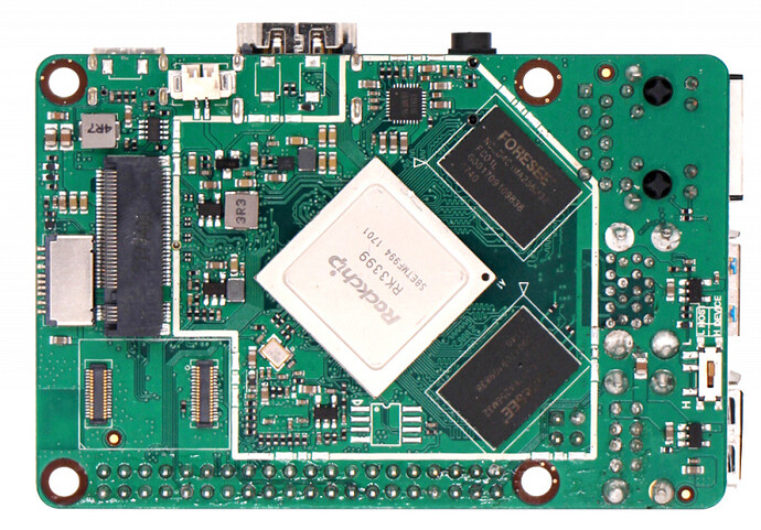

1.3 with SPI flash? Did you solder one yourself ?
So you got a chip there just below the cpu where the above shows empty?
No. It comes with the SPI flash soldered on board.
Just 1.4 is ver with soldered spi, 1.3 was like above.
Guess they may be soldering at source now.
It’s probably the 1.3 “limited edition” allnetchina is selling.
https://shop.allnetchina.cn/collections/frontpage/products/rock-pi-4b-4gb-v1-3-limited-edition-bundle
Possibly. They sell it as a bundle offer (the 4B board, 16MB SPI Flash, NVMe Extension and 16GB eMMC).
Exactly this one.
Oh that aint a bad price but dunno about that SSD, v1.3 myself no spi so can not test with integral ssd.
