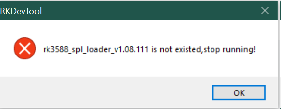

- rock-5b-spinor.cfg, after every every flashing guide references it but all the links to find it bundled with RkDevTool go back to https://wiki.radxa.com/Rock5/install/rockchip-flash-tools which is dead. (For anyone who is looking, I found it linked at https://dl.radxa.com/tools/windows/RKDevTool_Release_v2.96_zh.zip)
Unfortunately, the rock-5b-spinor.cfg references a specific SPL loader which can be found nowhere on Radxa’s docs/downloads.
I managed to find it at https://fi.mirror.armbian.de/dl/mekotronics-r58hd/u-boot/rk3588_spl_loader_v1.08.111.bin
