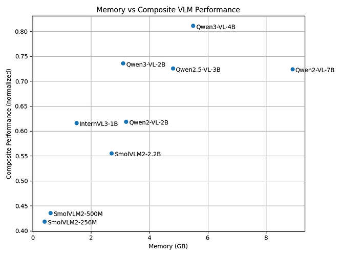

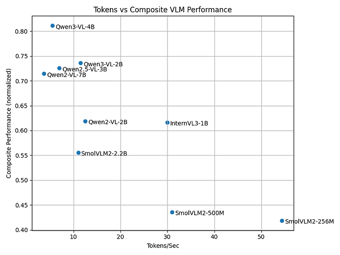

We have published the well-known SmolVLM2-VL models for the RK3588 on Hugging Face.
There are three flavours: 2.2B, 500M, and 256M.
As you can see, they are pretty fast.
