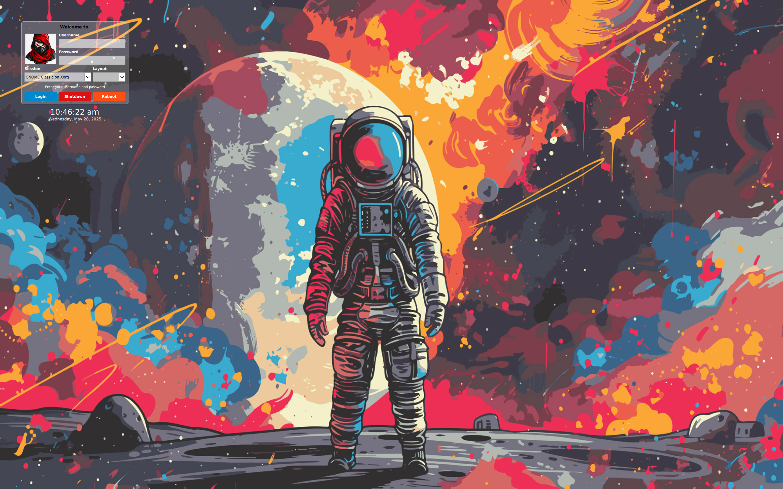

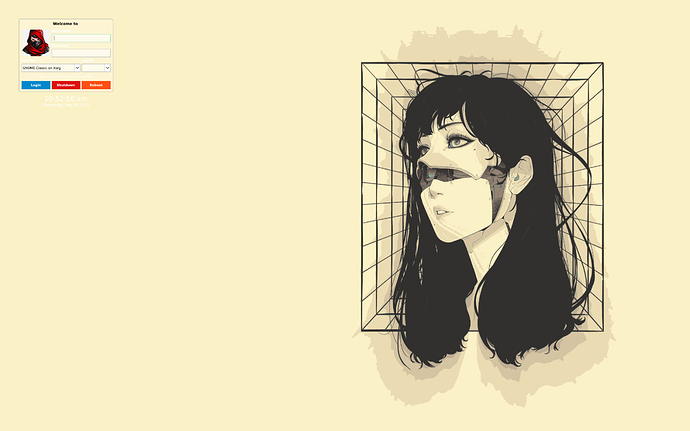

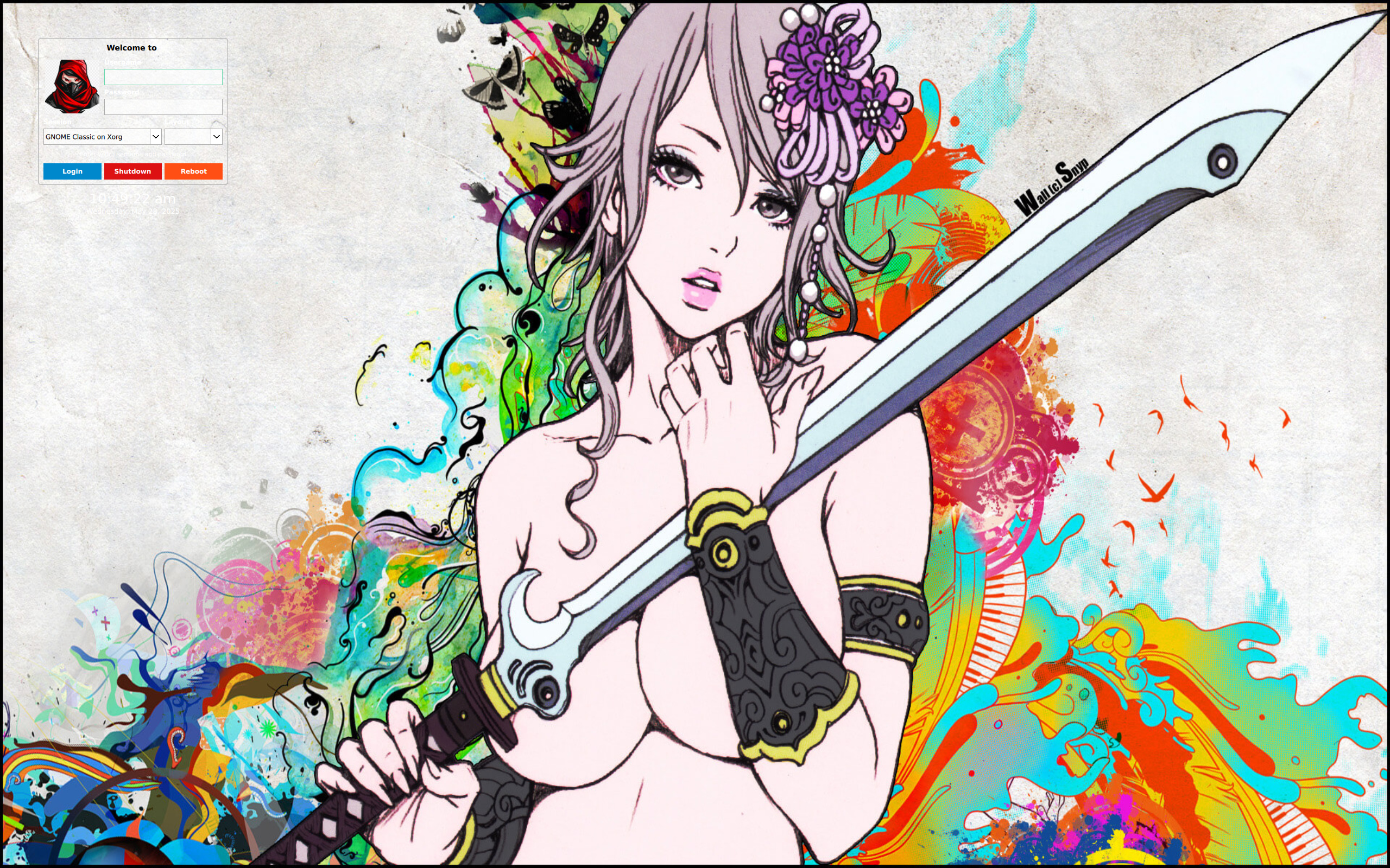

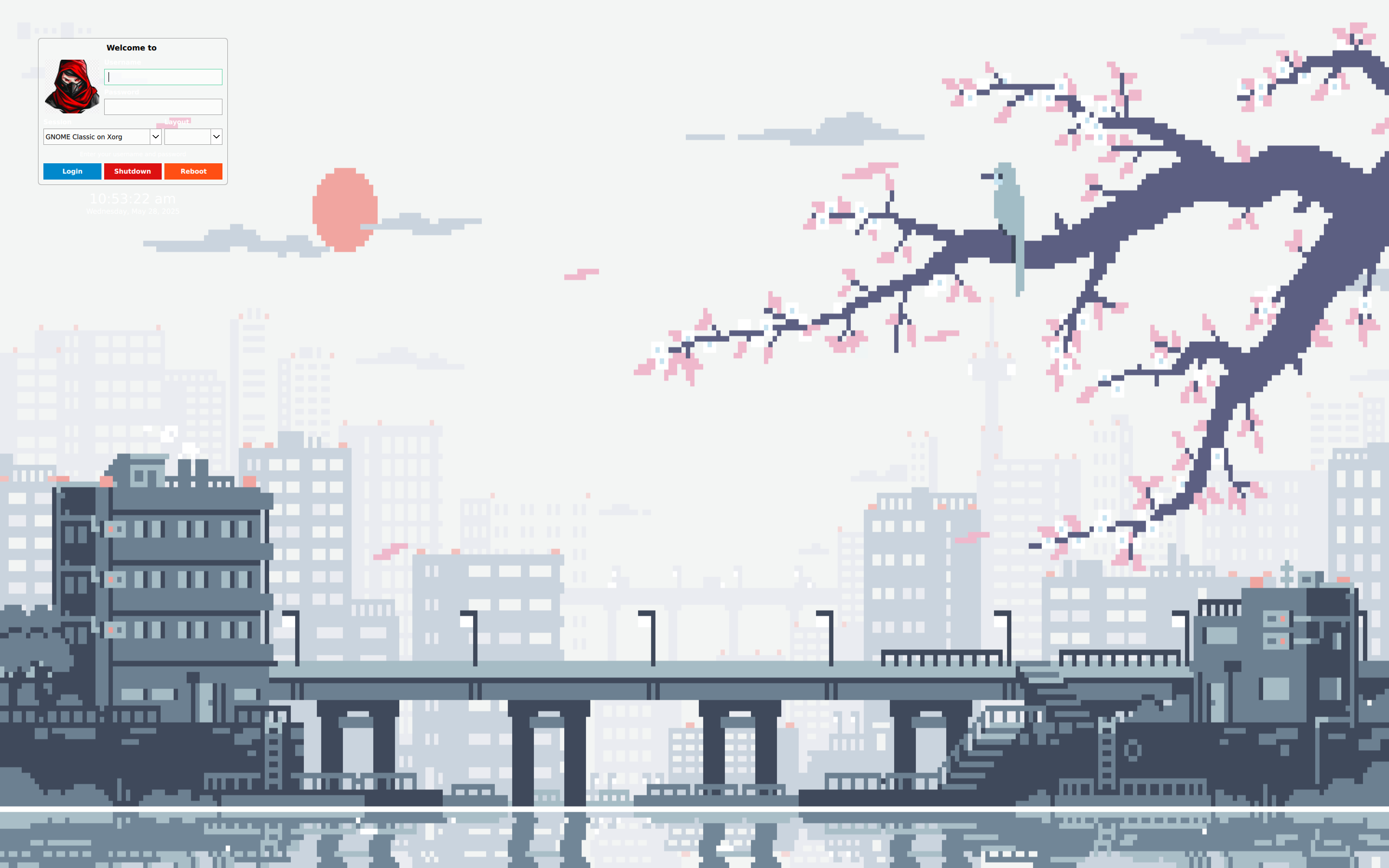

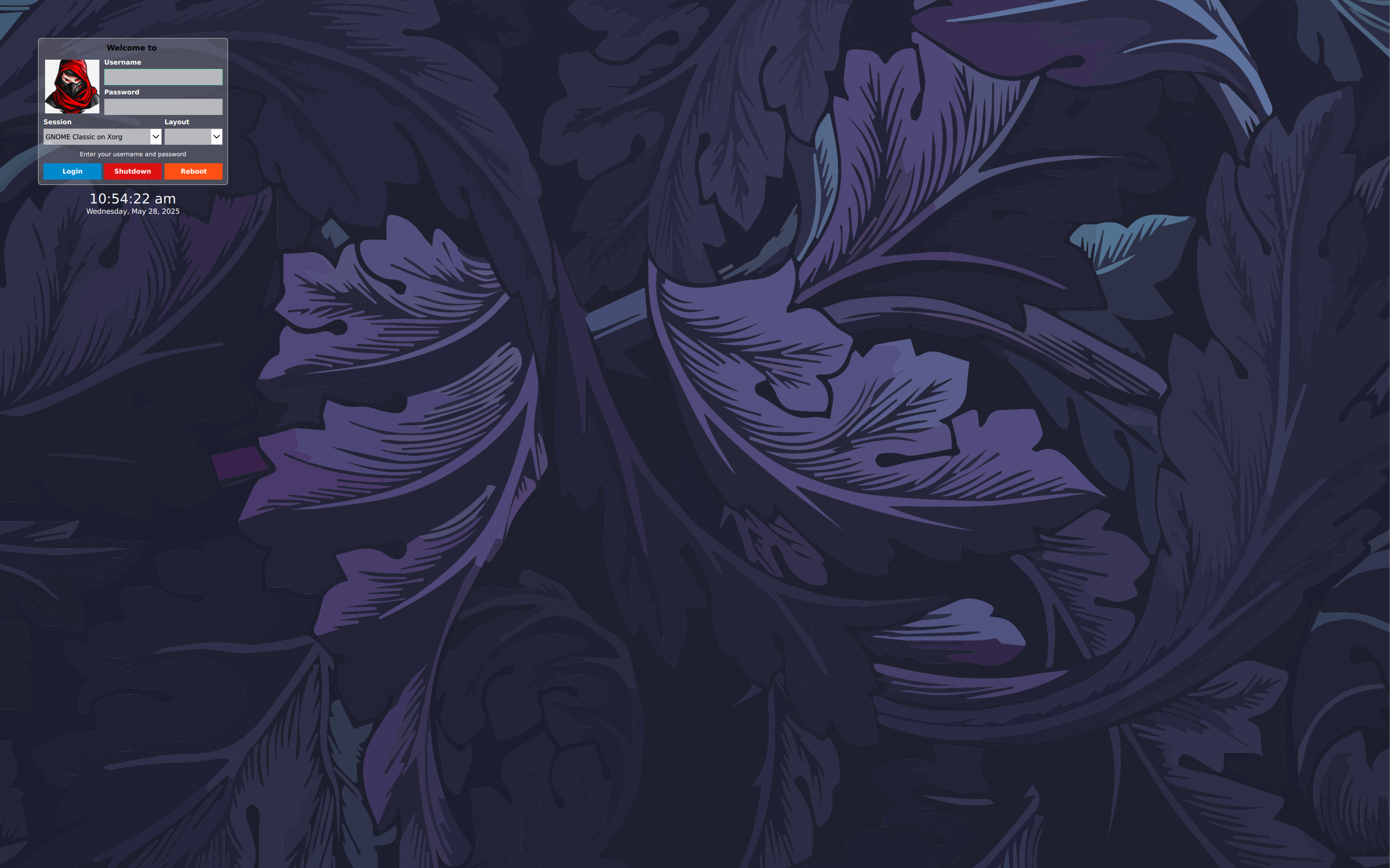

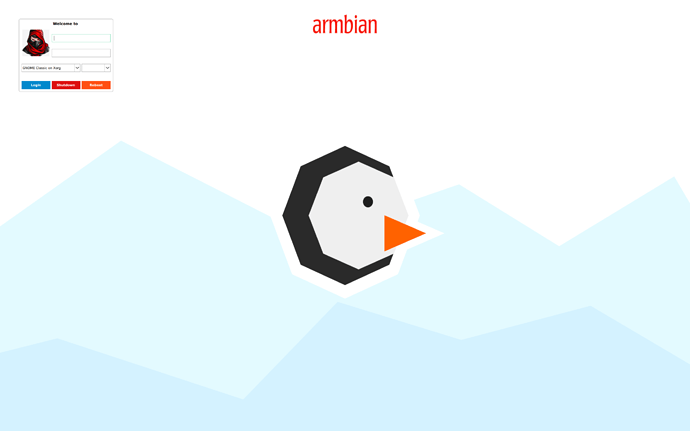

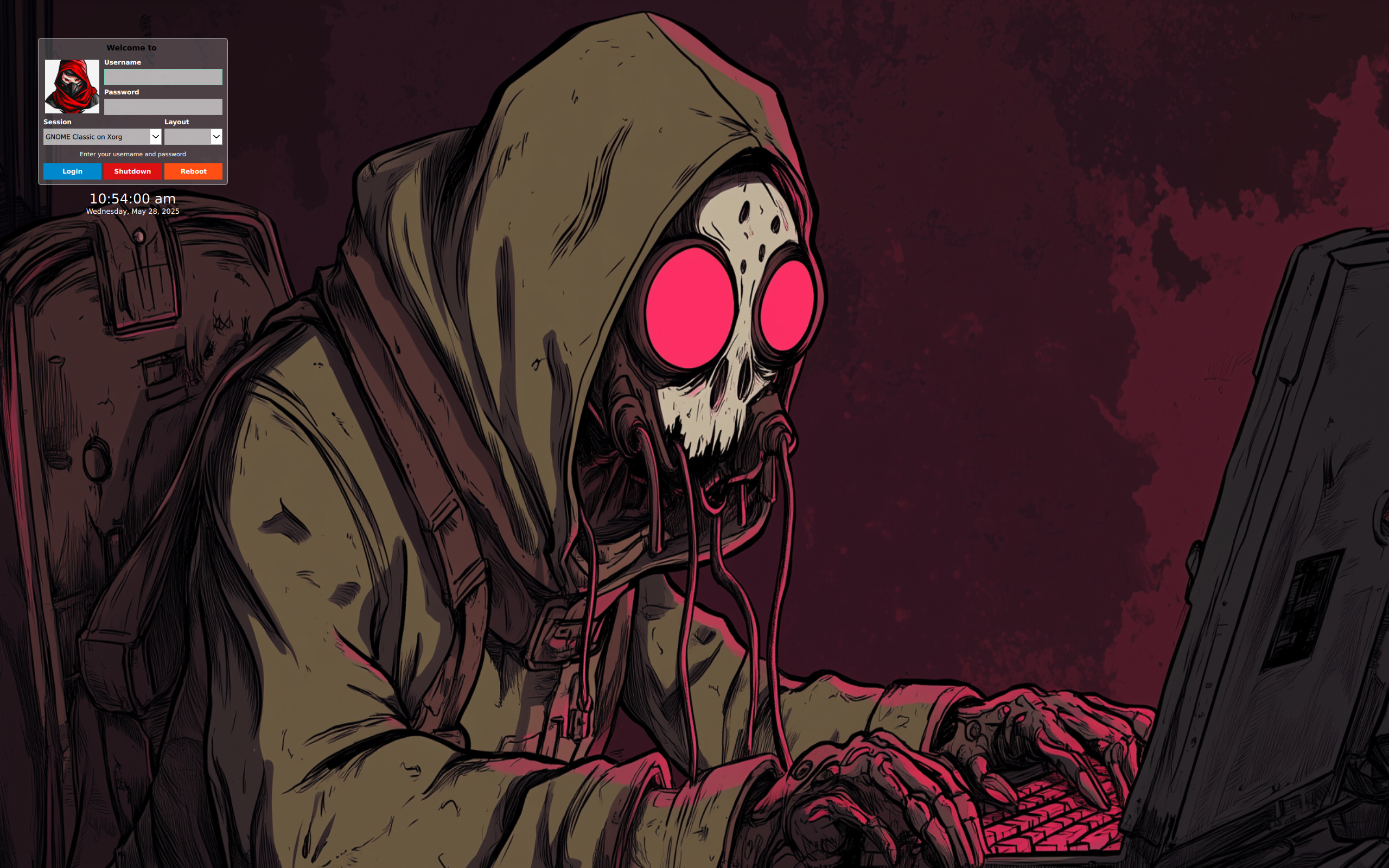

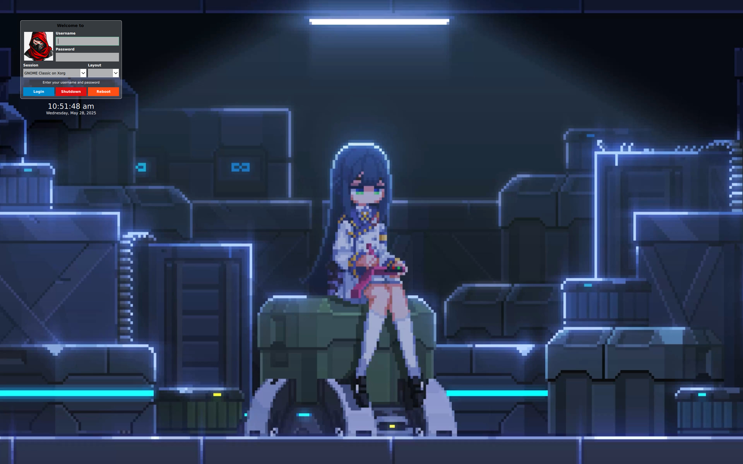

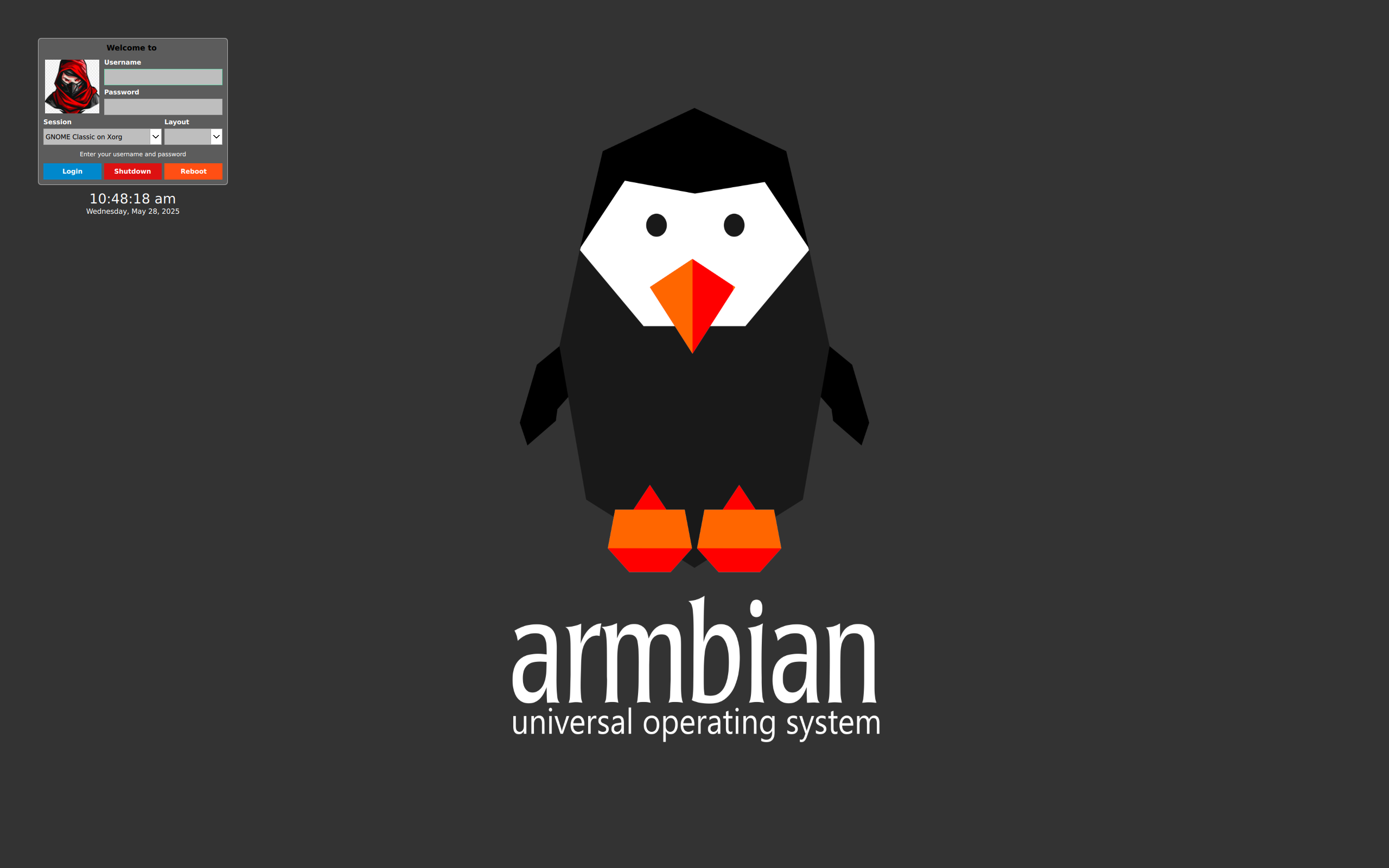

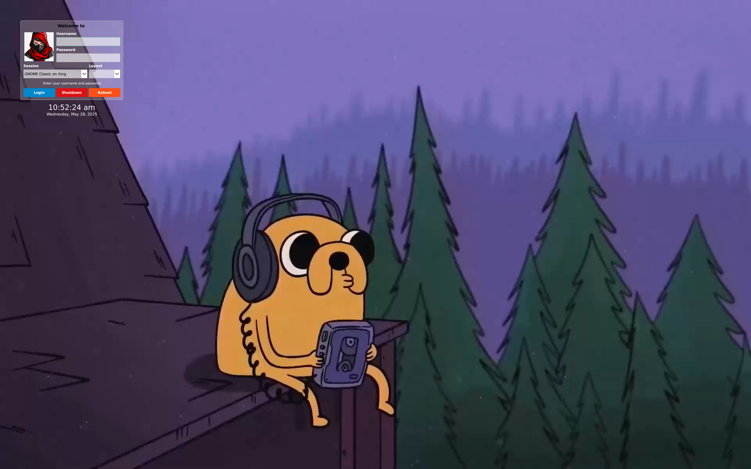

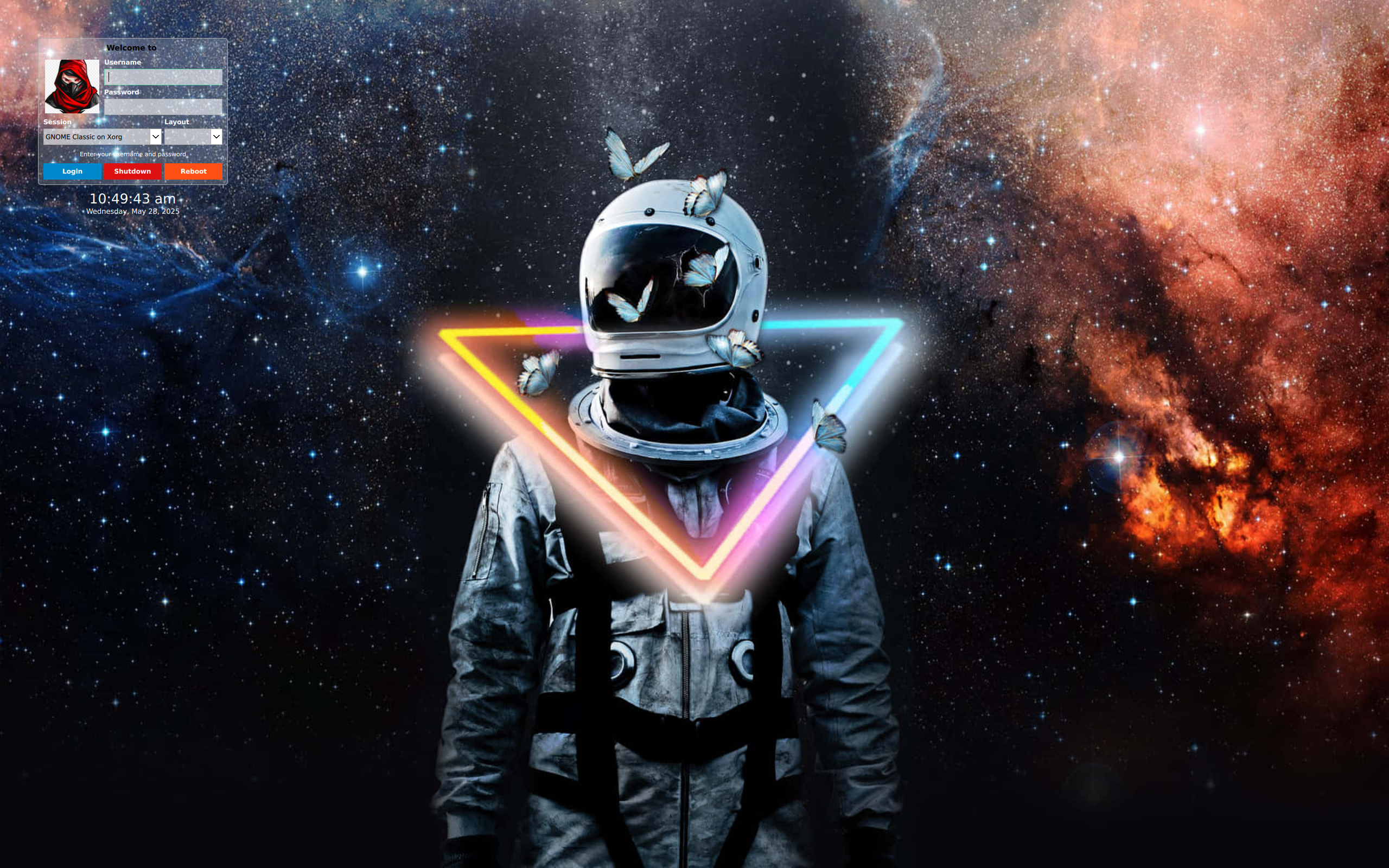

Preview
More Previews
pixel_sakura.gif - only with qt6
