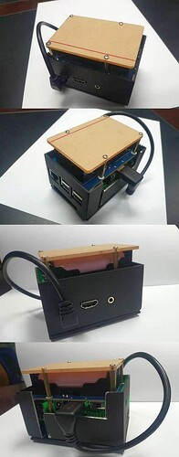

Just bought a waveshare 's UPS HATB module, which is designed for RaspberryPi 4,with both POGO PIN and USB output port, also support I2C to check battery status.
Original design was POGO PIN with 5V5A large current output, and I checked with seller, the USB port has only 5V2.5A output.
So I could still use it to power my RockPi 4B board via USB port, which works fine for now.
