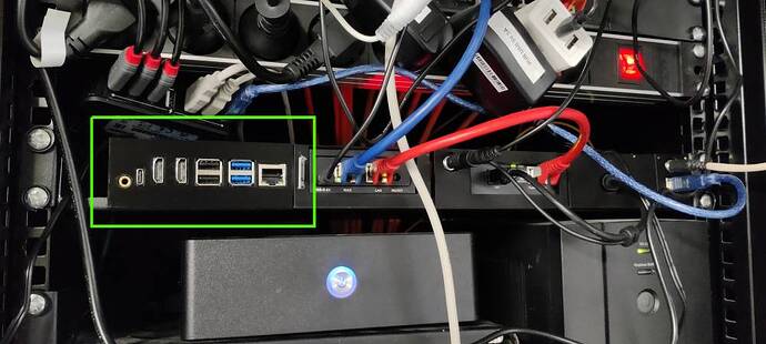

For devices I want to rack, i usually print a custom 1U enclosure, which fits a Digitus DN-19 TRAY
I did one for the Rock 5B, using as a model the v1.42_3D_stp file provided by raxda (with a bit of customization, because the space between the two hdmi ports on the model wasn’t exactly the same as what I measured on my board).
It is gradually taking place in my 12U 19" rack, next to his little brother, a RK3399 Nanopi R4S (the router of the house)

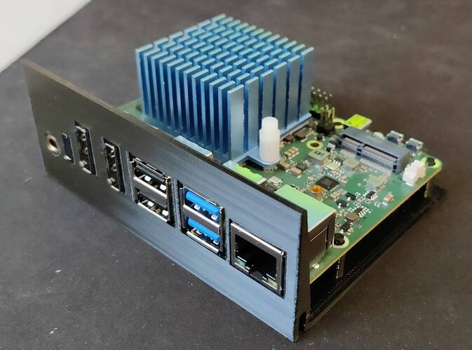

If you happen to use DAP mounts in your rack, i created this https://www.thingiverse.com/thing:5597882
Didn’t know such kind of ‘standard’ was existing. Thanks for the information ![]()
Originally from audio racks, very handy for mounting SBCs (;
@nouknouk That panel is great and it would be really great if Radxa just did a panel that has lugs to mount on the x4 holes you have used.
