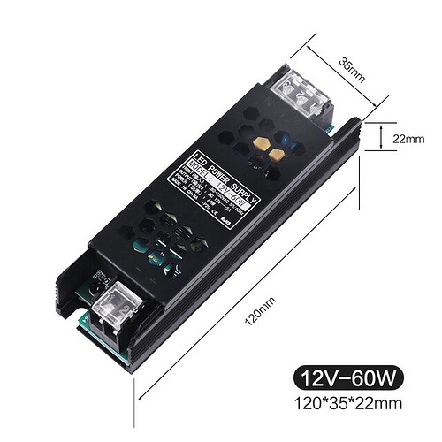

I’m now just using this power adapter, 12V 60W version: It is the smallest I could find: Built-in over voltage, over current, and short circuit protection. It is also suitable for CCTV camera, etc. It is just feeding the MP8759 Buck converter anyway. Mind that this adapter needs to be earthed. For me this is ok, as I’m going to build the Rock5B into a metal earthed enclosure.
12 Volt Power Supply Lighting Transformer Ac180-250v To Dc 12v 24v Power Source Adapter For Led Strip 60w-400w Led Driver - Lighting Transformers - AliExpress
Together with this cable:
My 12v 3amp and usb-c adapter from ebay is a tad wider but shorter but is wired and no needs for extra wiring apart from a usb-c to 5.5/2.1 mm barrel.
https://www.aliexpress.com/item/1005002351195556.html
https://www.aliexpress.com/item/4000404604554.html
Both would work but is not the 2nd slightly more tidy and convenient?

Using a 12V led(or any) driver is probably at the bottom of the list of recommended solutions.
Such is meant for fixed installations.
At least where I’m located it require installation by an electrician.
Even if installed with plug in a socket, most(?) countries do not make a difference in L and N(plug can be connected either way). No proper drag relief for the cords etc
