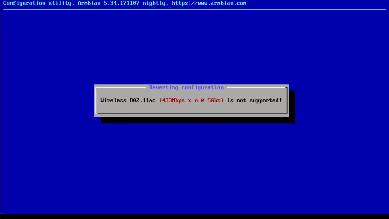

Has anyone been able to get this board working as a WiFi access point? I cannot get past:
rock@rockpis:~$ sudo service isc-dhcp-server start
Job for isc-dhcp-server.service failed because the control process exited with error code. See “systemctl status isc-dhcp-server.service” and “journalctl -xe” for details.
Hello igorp,
Thank you for the reply. However, I’m using the Rock Pi S which doesn’t have an Armbian image that I know of… definitely not one that’s supported. I am familiar with Armbian and how great it is (i’m running it on both my Tinkerboards). If you’ve gotten Armbian with armbian-config to work on the Rock Pi S, please tell me how you were able to do so.
Thank you for your help. I’m new to forums, I have the output of journalctl -xe in a .txt file but can attach it. The Forum is also saying it’s too big to leave in comment.
What’s the best way to get that output to those who can help? Sorry for the newness.
