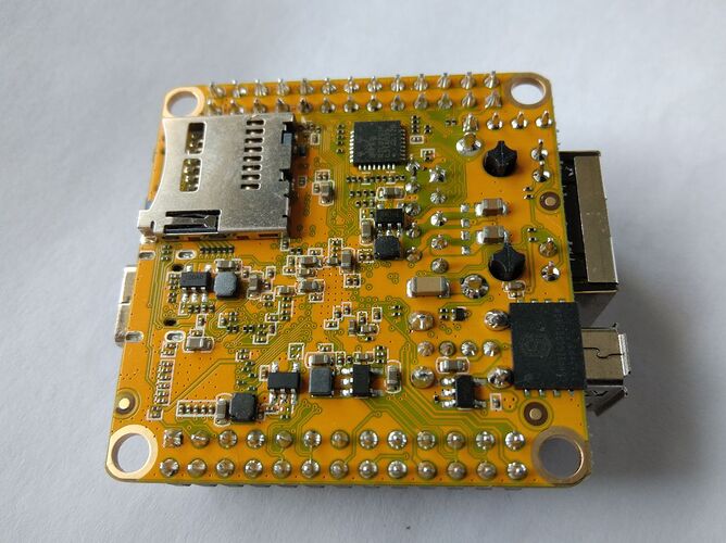

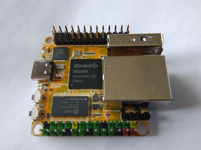

Hi, @marvin21
Can you take a picture of your ROCK Pi S, is it the S version RK3308?
