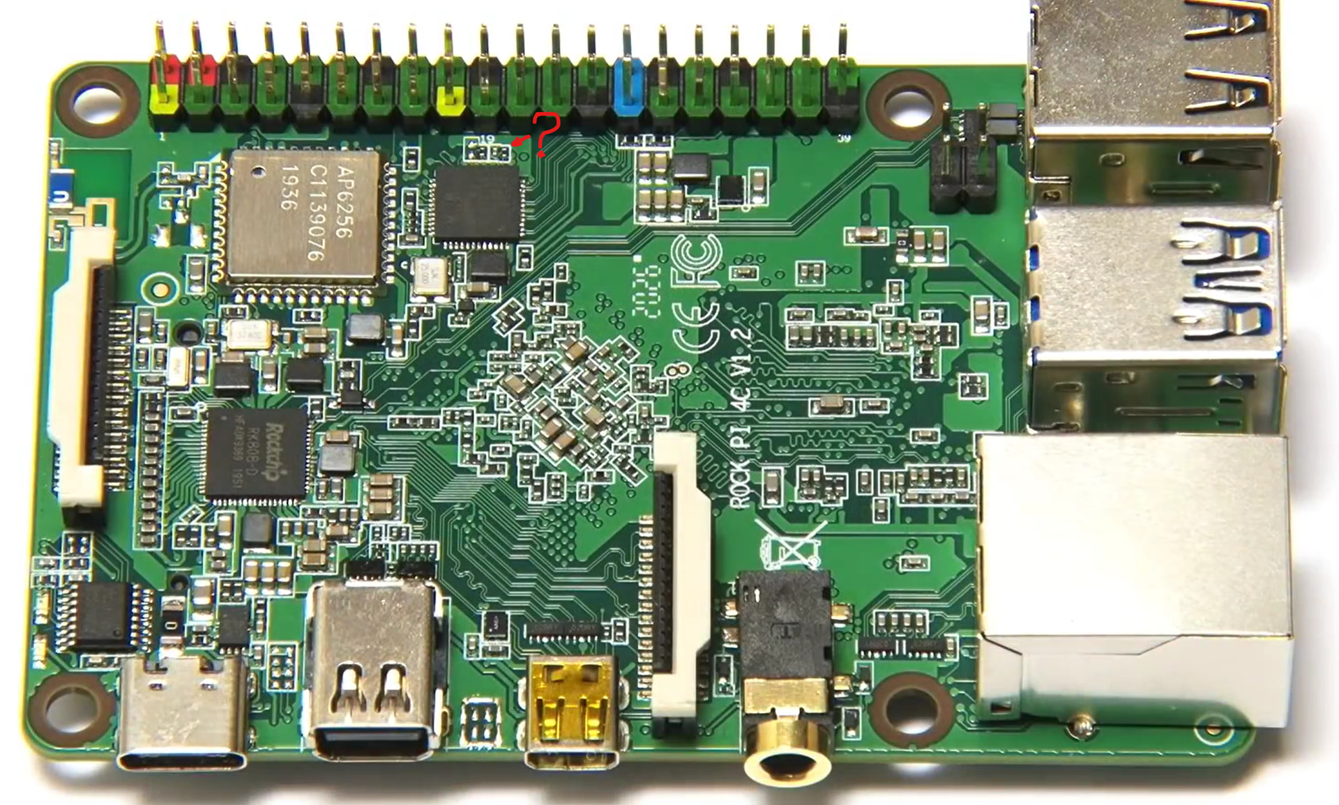

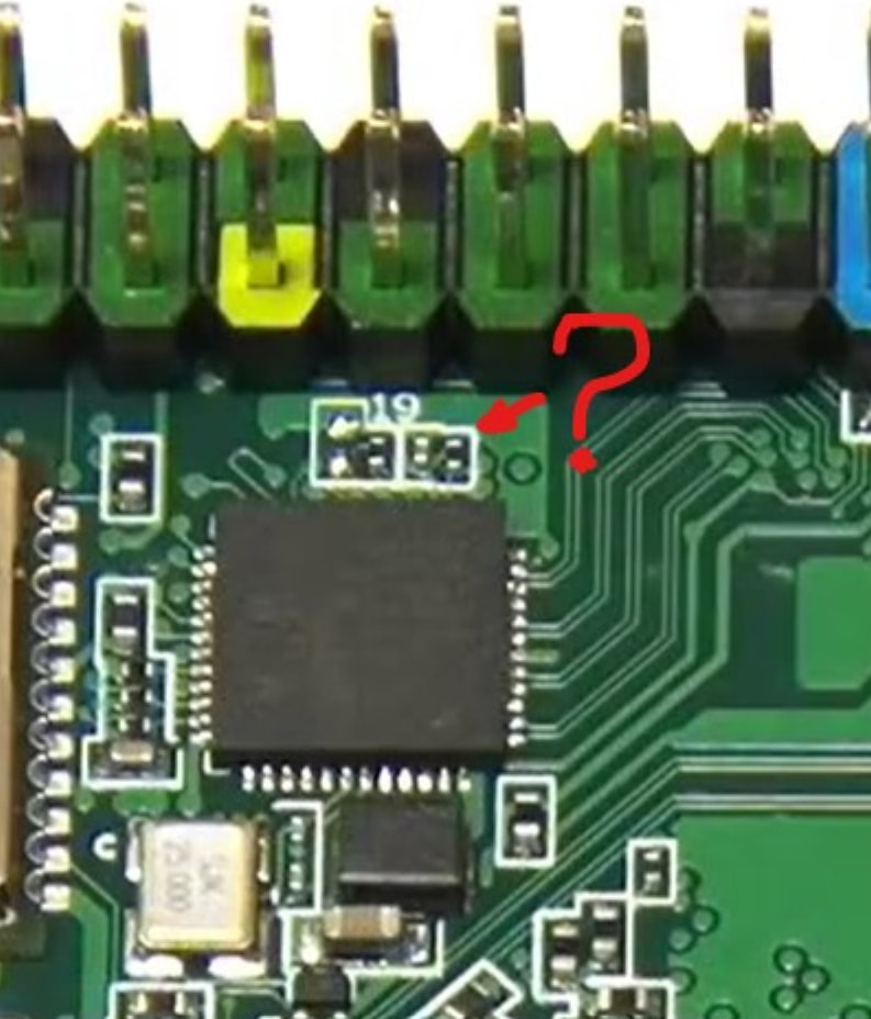

is it possible to know the nominal of resistor near RTL chip which I pointed on the picture?
this is very small black “brick“ from the right side of the block with number “19“
this resistor is absent on my board - so I can assume this is can be the issue..
it can be 0 Ohm if it is a jumper or probably 10k if it is some kind of pull-up..
Thank you!
You can check the SMD file for part number, and then check schematic for reference value. However, what actually used on the product is defined in the BOM, which is not open.
