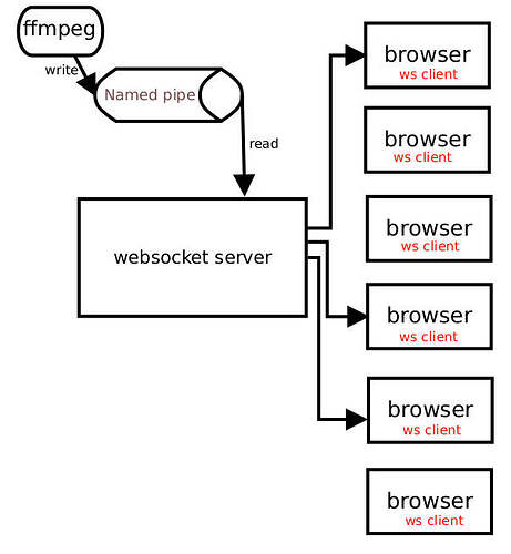

Here is the idea:
I created the named pipe and used ffmpeg to write to the write end of the pipe:
ffmpeg -f v4l2 -input_format nv12 -framerate 30 -video_size 1920x1080 -i /dev/video11 -c:v h264_rkmpp -qp_init 30 -b:v 2000K -vprofile baseline -vf format=yuv420p -r 25 stream.h264 -y
Somehow this POC did not work as expected, the first image is shown and the subsequent tiles are drawn but there is that annoying effect we see when there is insufficient bandwidth.
The good news is there is near zero latency, and i could push the h264 stream to more browsers without degrading much.
I am not sure if the ffmpeg pipe is correct or if using the named pipe is a bad idea.
