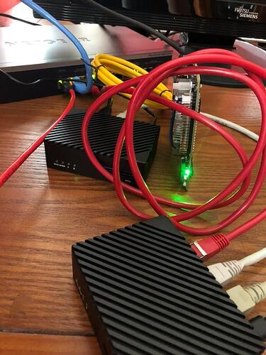

Those devices with black metal case must be nanopi’s R5S or R6S.
R5S as mentioned above when comparing performance/consumption between RK3568 and RK3588.
I’m about to setup a nice 2.5GbE ‘LAN party’ with those 3 ARM boards and 2 MacBooks with RTL8156 dongles :slight_smile:
BTW: never heard of R6S but there’s a little room for speculation about a soon to be announced NanoPi R3S (also based on RK3568).
