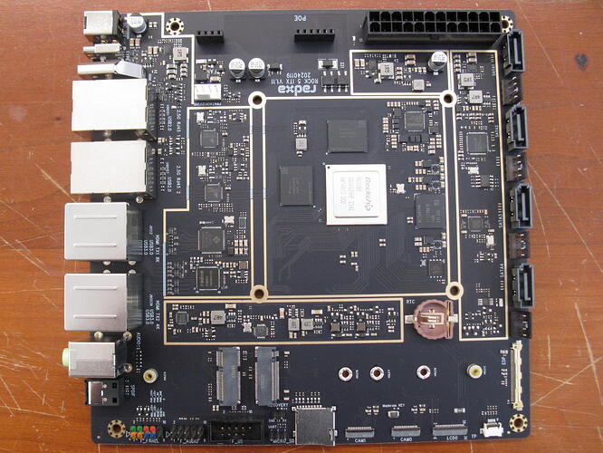

I’m also a lucky recipient of this really great board (thanks Radxa!). I’m sharing a few first-contact comments before I forget them:
  • the board looks amazingly clean and well arranged. I’m normally not sensitive to PCB colors but this black varnish that hides the copper tracks combined with all the golden pads makes me think of some high-end audio gear :slight_smile: Those who love to have a window on their enclosures to exhibit their boards to friends will probably be proud to have something new to show:

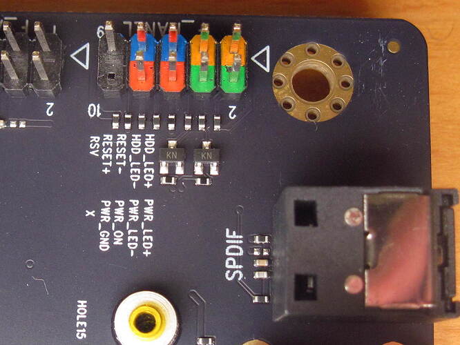

  • the connectors and pinouts are well marked. For example you clearly see RJ45-1 and RJ45-2 etc, as well as the front panel’s pinout. That’s one of the advantage of the black paint, the white marking is perfect and uniform so you don’t have any doubt when reading anything:
  • I think that a reset button close to the SPDIF connector (top right above) would be nice during testing or setup. For now I’m making shorts with a screwdriver on the f-panel connector.

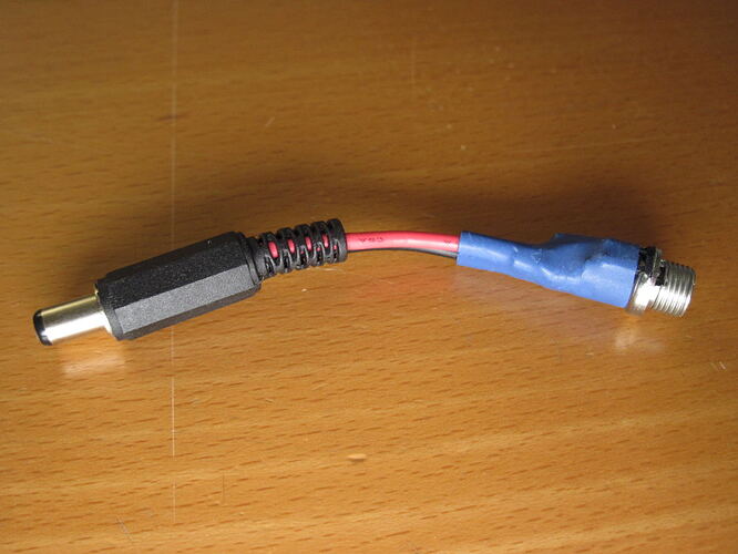

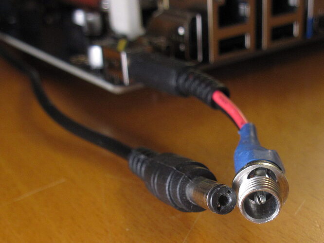

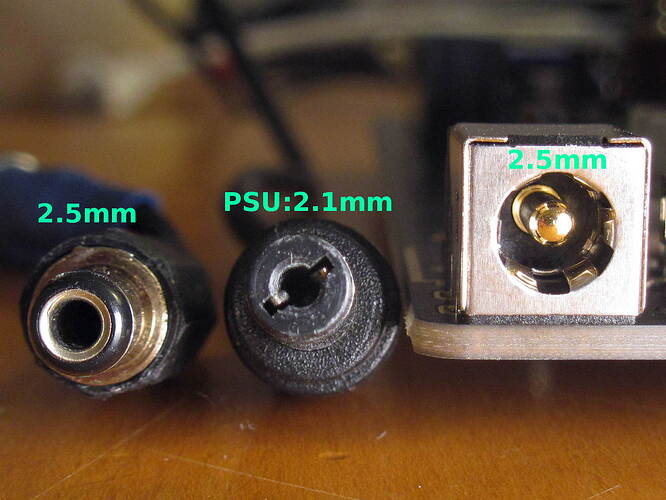

  • I was surprised to find that the 12V in is on a 2.5mm connector. I searched among all my power blocks (20+) and couldn’t find even a single one in 2.5, all voltages included:
    I found two salvaged male connectors coming from previous PSUs, so I connected one of them to a male 2.1mm connector to make an adapter:

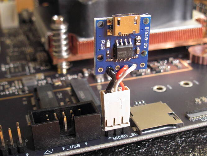

As an alternative I could have used a 12V->ATX adapter since I have one but I preferred to test the board without extra components first.

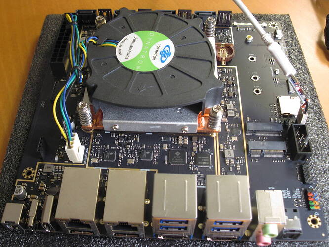

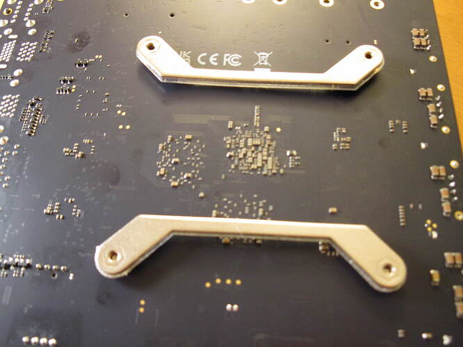

  • I thought it would be easier to find a heat sink, but I figured I didn’t seem to have the fixing back plate! I started the board without any heat sink and figured that it remains totally cool when idle. Regardless I managed to find one salvaged heat sink + fan + plate kit coming from two different devices that I could mount. I wanted to test it to see if the fan speed could be adjusted:
    I think it could possibly be useful to maybe provide a default plastic plate + long pins that allow to attach “something” with a pair of elastics or serflexes for use during early tests, since it’s likely not going to heat much anyway. I noticed that the fan starts at full speed and its speed significantly drops at the end of the boot, likely when properly set up to only adapt to temperature maybe.
