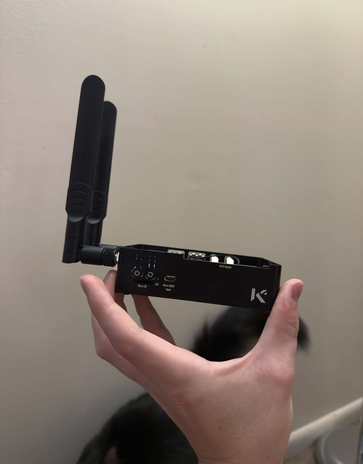

My KKSB case arrived today. This thing is gorgeous. Nice thermal pad, rubber bumps for the bottom, fits together nicely. So tempting not to buy one for personal use now.
Excuse the wifi antennas lol.
It really is ! I still havent ordered it… not sure if I will but I admit… its rock n roll baby! KKSB on Rad-a-Xa! :grinning:
Only thing that could be better would be a door on the bottom. I don’t use anything on the bottom of the board, yet at least so not an issue for me but, would be nice

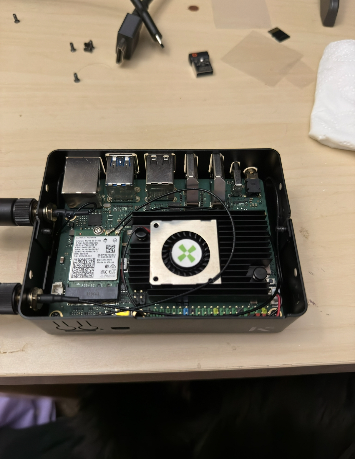

Wanted to follow up, since the Radxa 6240B heatsink arrived today.
Install was easy, the included pads are 95% correct but I needed to trim around one of the mounting holes for the cooler.
It seems to be making good contact, but I feel the included KKSB heatsink made better contact.
As for the good, I am loving it! Just ran sbc-bench and temps never exceeded 58°C! Typically I would see those temps after about 30-40 minutes of watching an anime or something similar.
I expected it to be quite loud from the few reviews I could find but, I do not find it to be very loud. I did set my own fan curve, so that may have an effect but even around 60% pwm it was a tolerable noise level I would not be able to hear over any sort of audio.

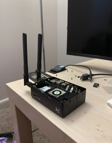

The comically large antennae are also new as of today. Wasn’t expecting them to be so big but, oh well :joy:
