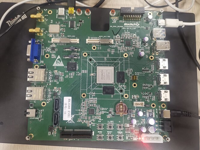

Some sample pics can be found here.
Yes looks like missing pcie.

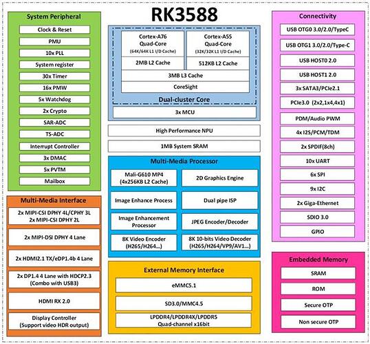

RK3588 is Rockchip’s latest octa-core flagship chip. It is specially designed for 8K scene applications. It has excellent performance and can be widely used in ARM cluster servers, edge computing, video codec, automotive electronics, PC and other fields. The expansion interface of RK3588 is also very rich, which is very suitable for industry product customization. RK3588S is RK3588 low-equipped version, the difference is similar RK3568 with RK3566 different, basically the same design framework, different segments oriented.
RK3588 can be said to be the general-purpose ARM SoC chip with the most abundant interfaces at present. The chip performance is also very balanced, and the video decoding ability is very prominent. It will have a wide range of applications in the audio and video field. Therefore, RK3588 is oriented to high-end industrial applications, while RK3588S frame is similar to RK3588, but with fewer interfaces, it is mainly oriented to consumer products. RK3588S has fewer video input and output interfaces, type-c interfaces, SATA interfaces, and RJ45 network ports than RK3588, and RK3588S does not support PCI-E expansion, which makes the positioning of the two clearly differentiated.
Considering that the stacking design of RK3588 and RK3588S is relatively complicated, it is recommended that you consider the product form of the core board and the bottom plate, and B2B connectors are recommended. At present, the height of the connector can be controlled to 0.4mm, and the impact of the connector itself on the thickness of the PCBA has been very small. The core board products have a great effect on reducing the development cost of multiple projects, including the later inventory cost.
The package size of RK3588 is 2323mm, and the package size of RK3588S is 1717mm. RK3588 is more suitable for industrial supplies with little restrictions on product volume, while RK3588S is more suitable for portable equipment. In general, the performance of RK3588 and RK3588S are consistent. If the usage scenario is relatively simple and the interface requirements are not complicated, it is recommended to consider RK3588S, which can effectively control the cost. On the other hand, if it is a product that needs to be used across scenarios and has complex interface requirements, RK3588 is recommended. Judging from the performance design of RK3588, it can meet the iterative needs in the next five years and is very suitable for AIoT applications.
