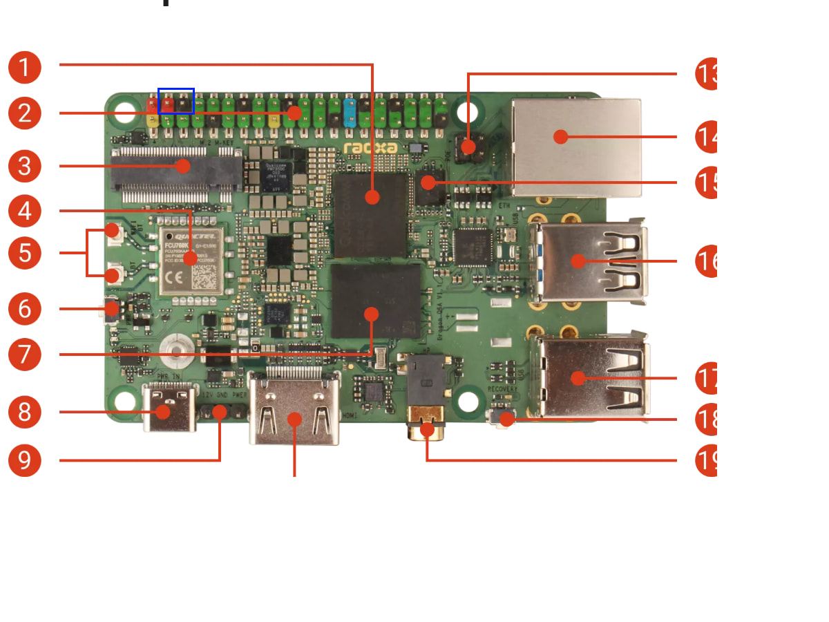

You can hook a 5v fan to the headers - I use a 30mm fan and heatsink meant for some raspberry pi models. While there’s no dedicated fan headers, these fans are quiet enough that active speed control isn’t needed - I’ve switched to a metal case but this is the setup I’m using now - and that thread’s probably got some good options for you
You can tap power from the two pins I’ve squared in blue - I guess any pair of red and black headers would work to give you 5v

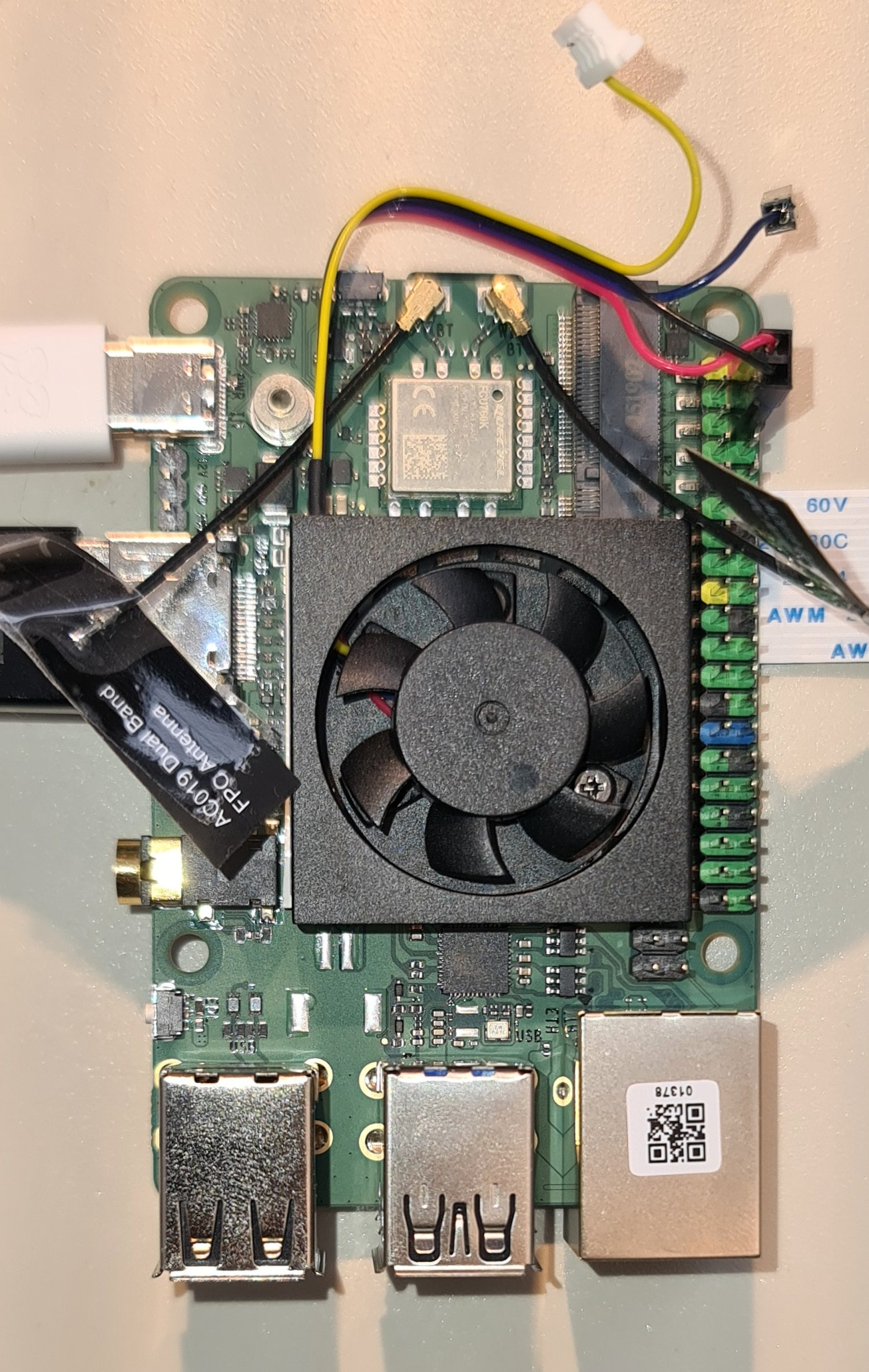

This is my solution:
It’s a “3007 cooling fan for the Raspberry CM5” (Compute Module 5) like this (look at your local dealer):
You can remove the retaining plates. Instead of the included thermal pads, I used self-adhesive thermal tape for mounting (and insulation) across the entire underside
The fan has four connection wires because it allows PWM control and the tapping of a “tachometer” signal. However, it is sufficient to simply connect the red and black wires to a +5V and a GND pin of the 40-pin GPIO header.
Although it runs at full speed constantly this way, it is still very quiet.

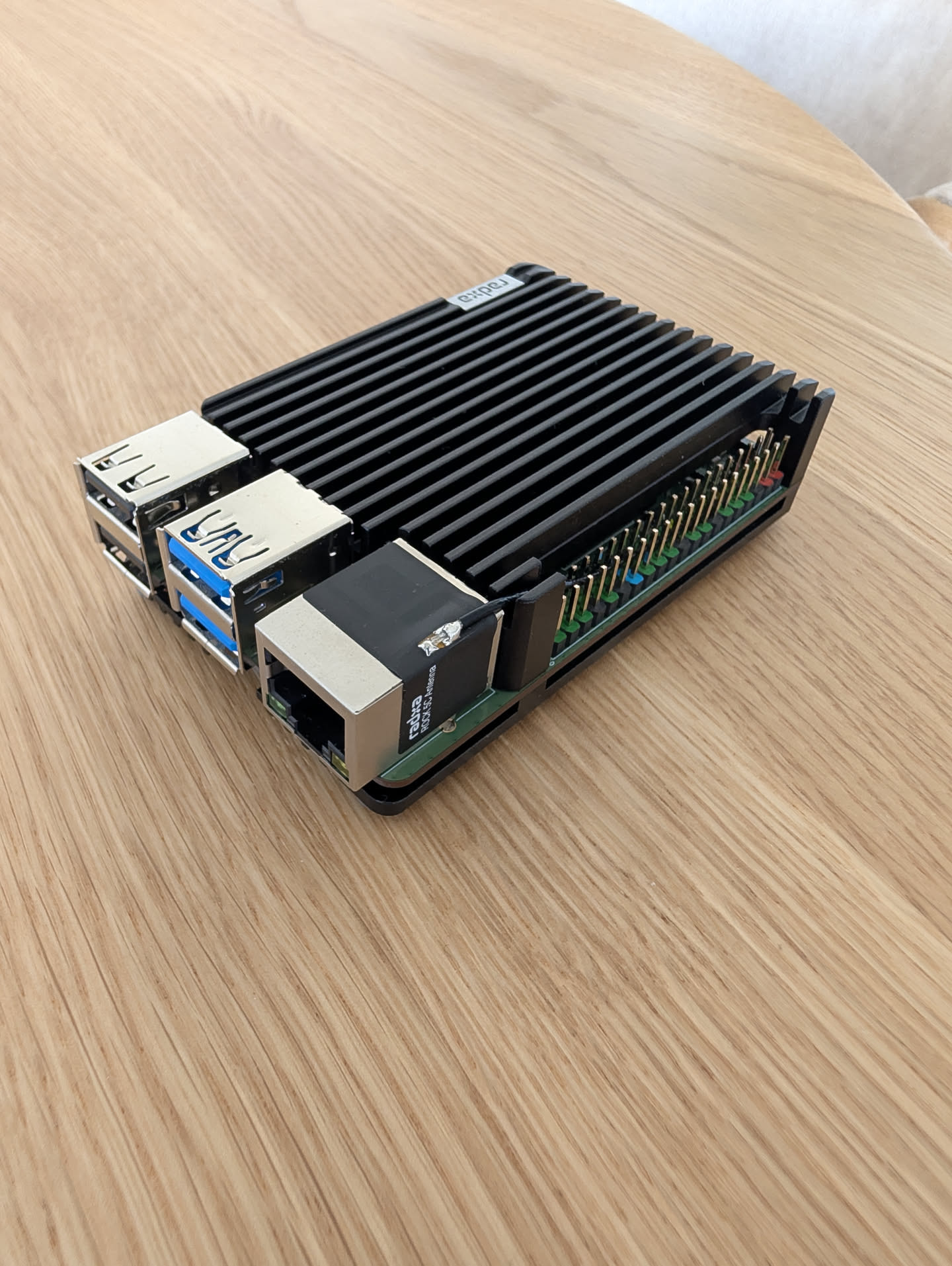

I can suggest Armor Case 7056A. 40°C idle temp on 23°C room temperatur… and it is super quiet and looks great!

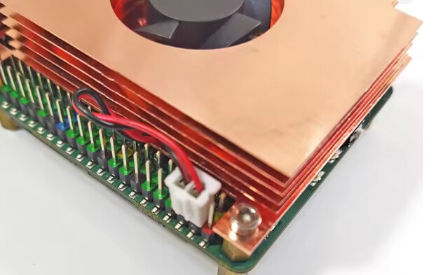

I bought the copper fin with fan on the picture above by @Bob_Weurman and it does indeed work very well!
Even if the fan is constantly on, it does not matter because it is so quiet.
