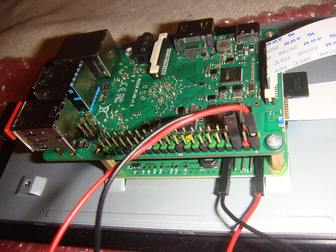

Thanks for reply. Image does not work. It starts, shows the lock screen but does not react on touch. After a few seconds display goes blank an never awaks.
Take a picture of how you connect the i2c wires. You can use a mouse to unlock the screen first.
The connection should be right. Can you turn the USB OTG switch to device and connect ROCK Pi 4 to PC and check adb debugging? You need a usb A to A male cable.
No connection is not right. This board uses I2c pins for touch display.
Now the image works fine. The only issue i found is that the display timeout
