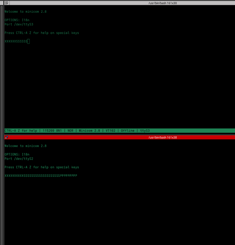

There is an issue with the images for Radxa Zero 3 - it seems that UARTs don’t work properly. RX is ok, but there is no chance to send anything with TX. What is interesting, console over UART works perfect but if I want to use UART3 or UART2 with i.e. minicom they don’t send data. Similar problem with image from armbian. The only one which have worked correctly was Ubuntu version by Joshua Riek. Would it be any chance to solve the issue?

Yes, exactly, I started test with your official image and when I noticed the problem, I extended testing to other distributions. I’d be happy to use your official image but the UARTs TX do not work - I’ve teseted UART3 and UART2 and both of them have the same issue - RX works ok, TX doesn’t. I noticed, the same problem is with armbian and dietpi images.

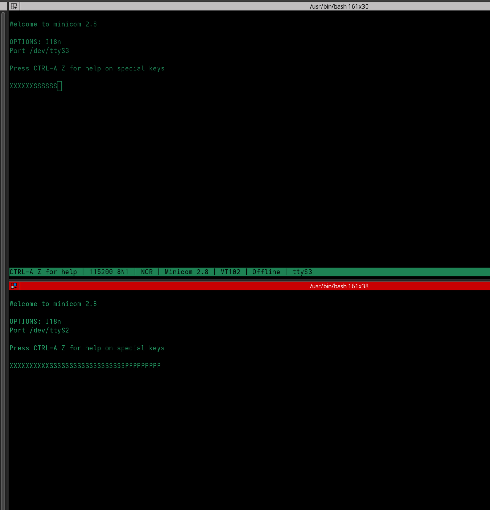

Steps :slight_smile: - installing image, installing minicom - board receives correctly but doesn’t send anything over TX

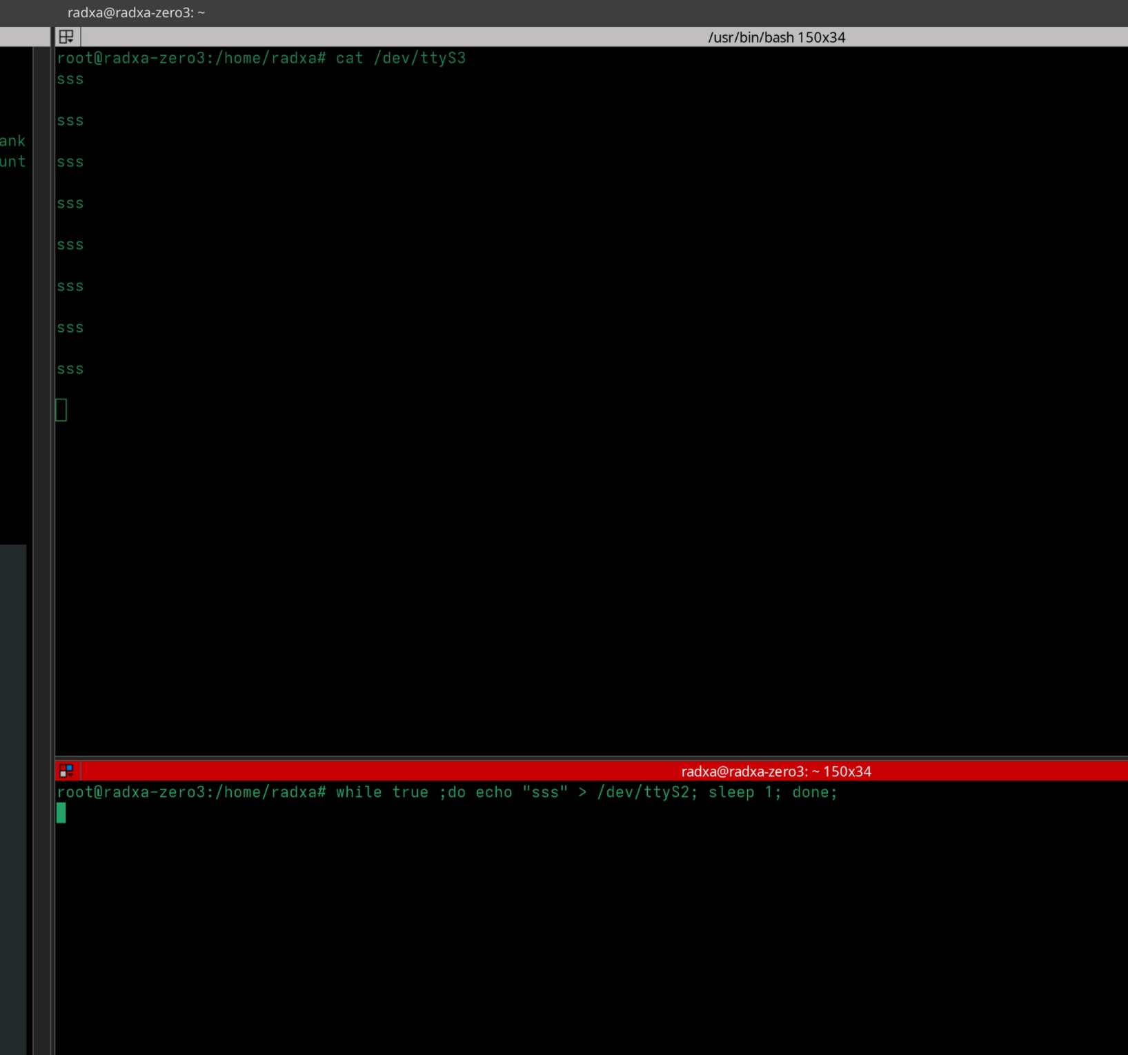

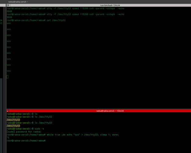

pictures above are the result I tested.

Thanks for the update - yes, indeed it works with this comand “root@radxa-zero3:/home/radxa# while true ;do echo “dfsdfsdfs” > /dev/ttyS3; sleep 1; done”. Before I testet UARTs with minicom and TX did not and still does not work or I do sometthing wrong. In Ubuntu I managed to run the UARTs without any problems and also to change console from UART2 to UART3 doing some changes in u-boot.

You need close the Flow Ctrl option
