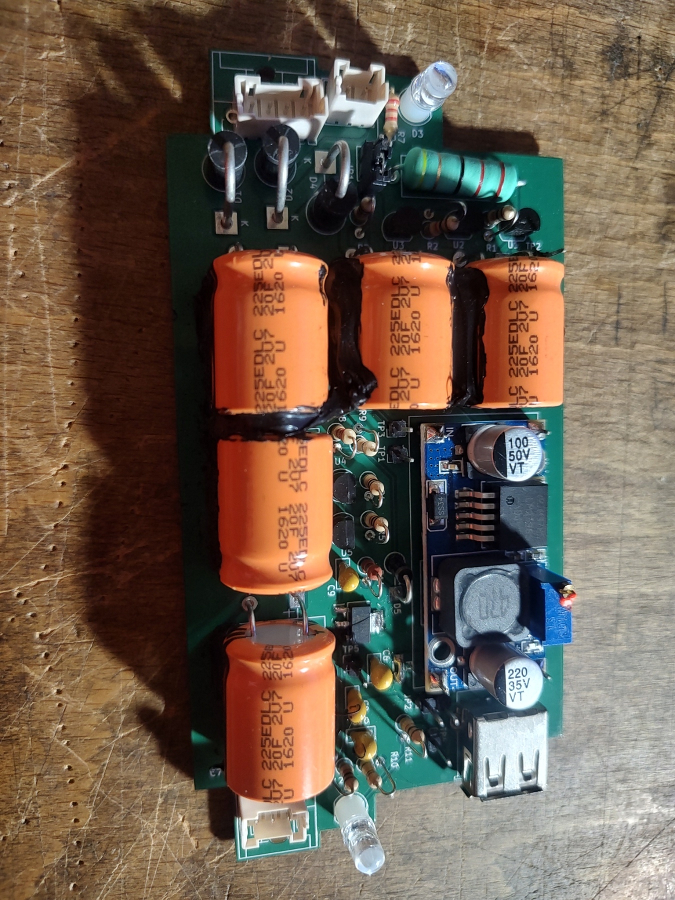

Not Radxa but similar (UpBoard) I made a UPS using supercaps that will keep the board alive for about 1 minute. It is designed for 5V but will work with the 12 V the Radxa needs - though I have yet to test it with the Radxa. The UPS has a 3.3V output that drops to zero if the power supply fails, I monitor this on one of the GPIO inputs and if the power outage is more than 10 seconds the system performs a controlled shutdown. My application is automotive so the UPS protects the system from varying voltages, particularly when the engine starts. I used Supercaps as I didn’t want the fire risk associated with LiPo batteries.
