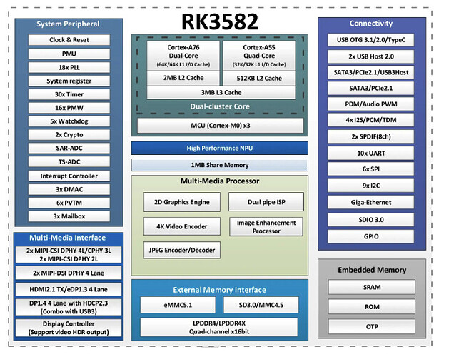

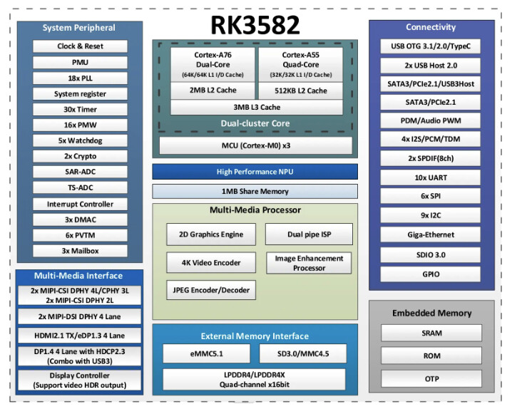

I was also wondering about same topic. It seems that Lite version doesn’t have decoder but has encoder? Really strange I didn’t know it was even possible. I was planning to buy it with jellyfin server in mind but now I’m not so sure as it is lacking hardware decoder. Currently all 5C regular are out of stock except really expensive 32GB ram model which is a bummer. Will 5C Lite still be fine for multimedia server even without hardware decoding?
The absence of either a decoder or encoder will prevent hardware transcoding in Jellyfin.
In fact, the hardware decoder on the 3582 is also a lottery, once you win the gamble (dual-core decoder + dual-core encoder), you can get better transcoding performance than the Intel N100.
Even if the GPU used to accelerate tone mapping is marked as failed, it can usually be forced to be enabled through a U-Boot patch, which is usually not a problem for headless OpenCL tasks.
