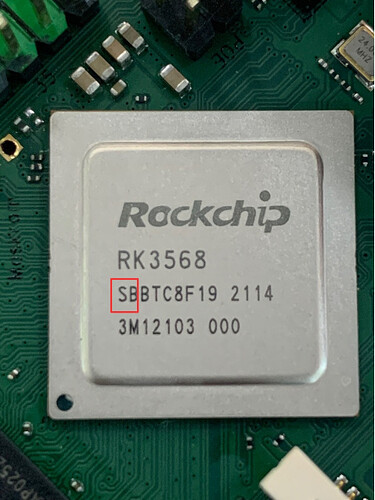

Due to the version difference of the RK3568 chip, it may fail to burn the image to EMMC in MASKROM mode. If you find that your ROCK 3A cannot burn the image to EMMC through MASKROM mode, you need to use a specific loader to burn it:
Note this issue only happens on RK3568 SB revision batch chip when flashing/upgrading from USB OTG to eMMC in maskrom mode with rkdeveloptool/upgrade_tool or Windows RKDevTool, to be specific, this wiki guide.
If you use eMMC module and write it on PC with SD-to-eMMC adapter or eMMC reader, all the chip revision can work without any issue.
