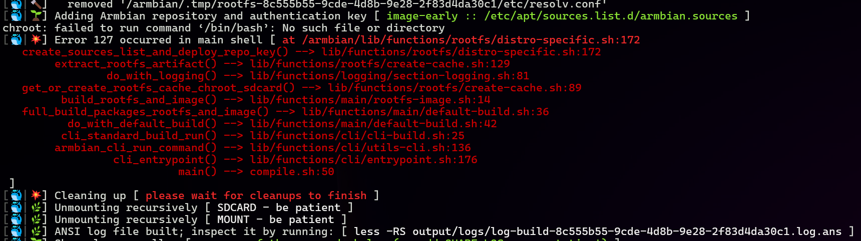

after recent update three instances throws this:
I created yet another vm and retry, same result, just curious what and where is something wrong now :slight_smile:

Which image were you trying to build? I once had to wipe the whole build/ directory and repull armbian to get it working again.

Any known and described issue?
Nothing changed :frowning:
I tried several sbcs and their configs, all ends with same error

So I have it on plain fresh git pull, on both debian and ubuntu
just curious if anybody else managed to get same error now..

Probably this commit broke it:
quick fix is just to comment out var: APT_SIGNING_KEY_FILE
or chroot ln line
