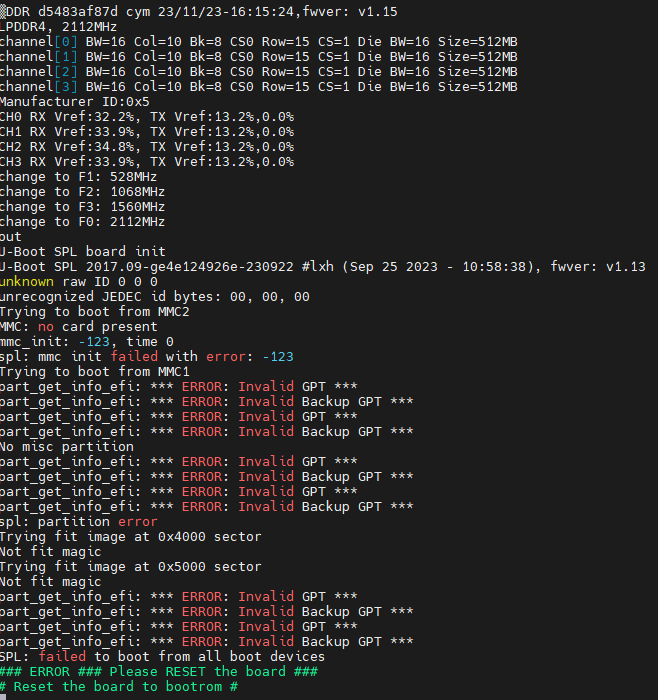

I need some help with my Radxa E52C device which is failing to boot. It was working fine, but suddenly today when I tried to power it on, it displayed a series of errors on the console and couldn’t start the operating system.
I’ve attached an image of the error screen, but here’s a summary of the key points I’m seeing:
  • U-Boot SPL 2017.09 is initiating.
  • It attempts to boot from MMC2, but indicates “MMC: no card present” followed by “mmc_init -123, time 0” and “spl_mmc_init failed with error: -123” .
  • Then it tries to boot from MMC1, and this is where I see multiple errors like **"part_get_info_efi: *** ERROR: Invalid GPT *" and **"part_get_info_efi: *** ERROR: Invalid Backup GPT *" .
  • There’s also a “spl: partition error” .
  • It attempts “fitting image” in different sectors (0x4000, 0x5000) but both fail with “Not fit magic”.
  • Finally, the message is “SPL: failed to boot from all boot devices” and "* ERROR ### Please RESET the board ###"** .
I’ve tried resetting the board several times as suggested by the message, but the result is always the same.

Hi @yu0ew,
It looks like the image is corrupted.
Which storage medium are you booting from—eMMC or SD card?
You can try reflashing the system.
Hi everyone, this device is proving difficult to work with, mainly because the pre-installed software is in Chinese. I was running Debian off a microSD. I’m currently stuck trying to understand why a Maskrom flash isn’t letting me exit that mode. I’ll be checking the links provided for more guidance.
