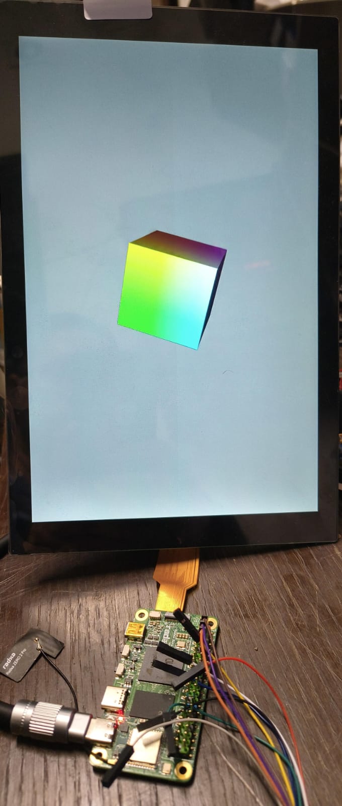

managed to get it almost working on armbian with custom driver. still got problems with colors and display flickers to right from time to time. but at least it is displaying content
with v25.11 armbian branch
added files
userpatches/config/kernel/linux-meson64-current.config
userpatches/kernel/archive/meson64-6.12/simple-panel.patch
build image
./compile.sh build BOARD=radxa-zero2 BUILD_DESKTOP=no BUILD_MINIMAL=no KERNEL_CONFIGURE=no BRANCH=current RELEASE=noble INSTALL_HEADERS=yes
flash image then you can use
armbian-add-overlay armbian-radxa-zero2-display-10fhd.dtso
radxa-10fhd-on-zero2.zip (36.1 KB)
currently no touch/pwm backlight ( only on/off ) but i’ll work on that
probably someone from radxa support team can take a look and alter it so it could work on normal radxa image
edit: made a booboo in naming files. armbian-add-overlay accept only dts files. so rename dtso to dts
