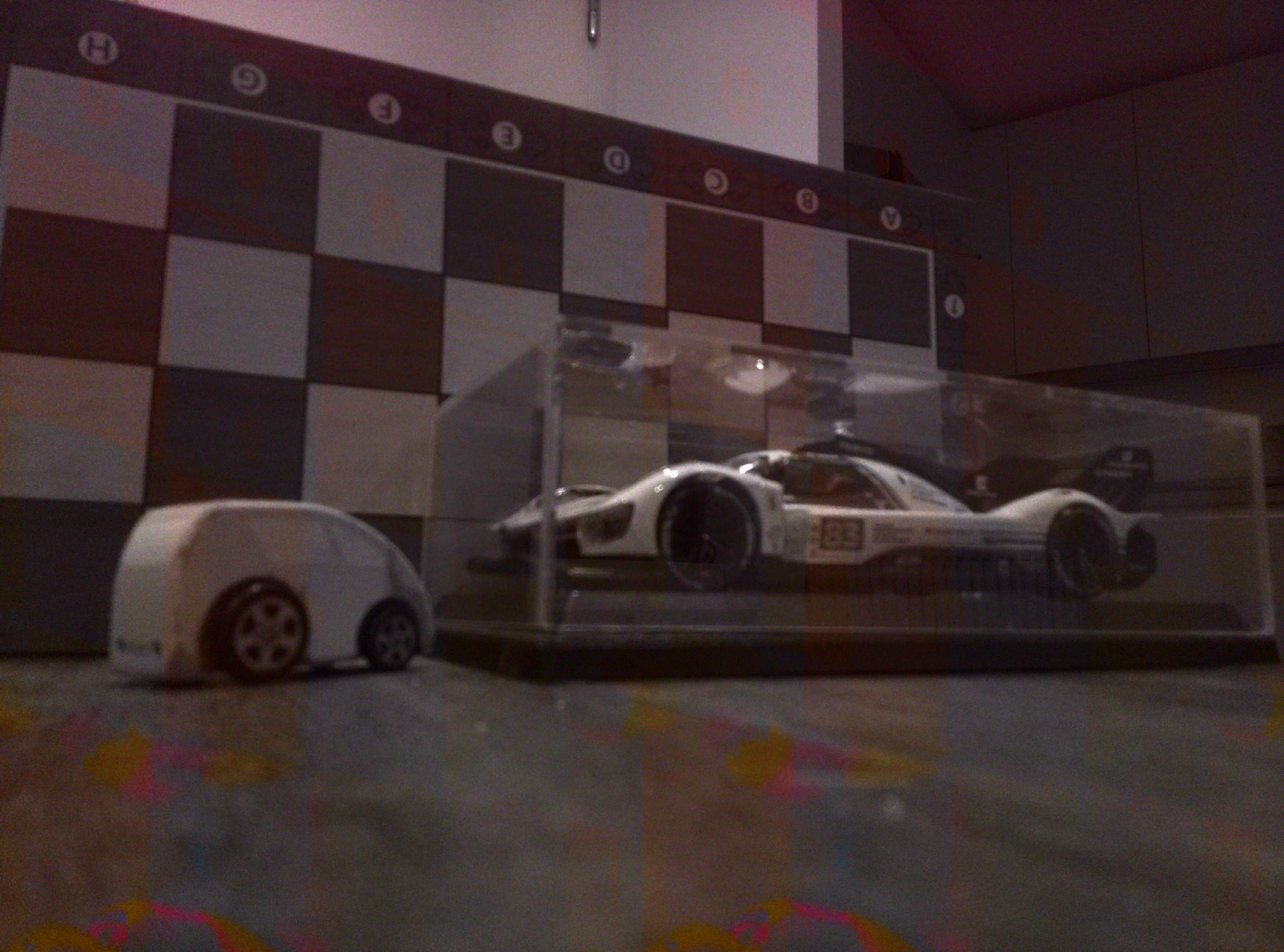

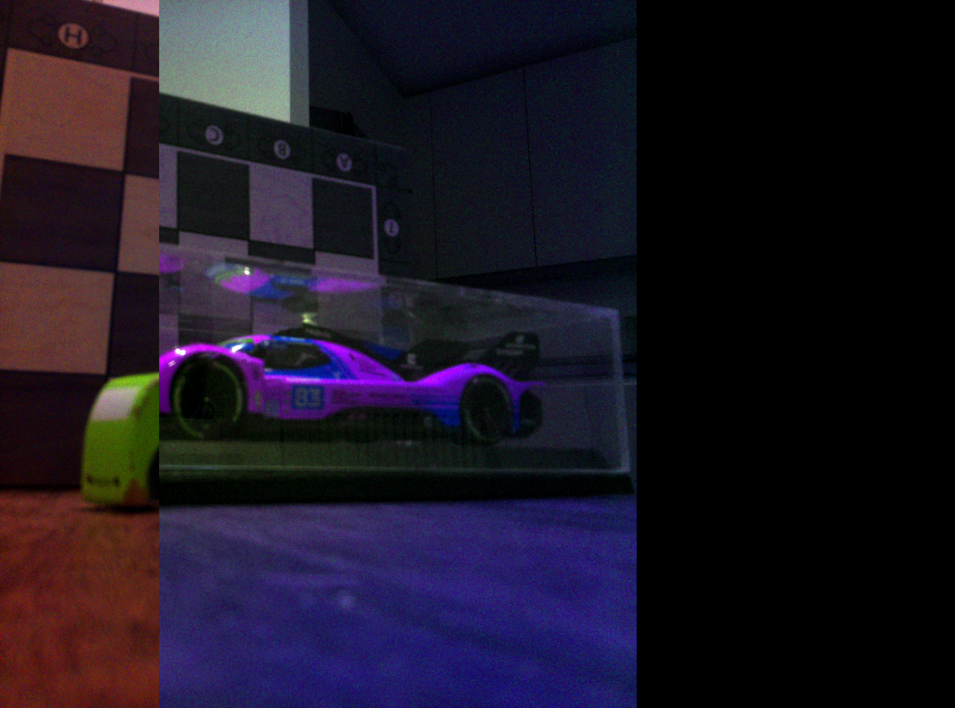

Saving a still frame (or video) from the camera results with an image that seems to have two issues:
  • incorrect color encoding; NV12 produces near B/W image with some coloration and slight ghosting. I’m getting parts of the image correct when using BGR option, but
  • then 2nd issue comes in where picture doesn’t seem to be well syncronised; part of picture cut vertically.
NV12 picture:
$ gst-launch-1.0 v4l2src device=/dev/video1 en-awisp=1 en-largemode=1 ! video/x-raw,format=NV12,width=4208,height=3120 ! jpegenc ! multifilesink location=file4.jpg

BGR picture:
$ gst-launch-1.0 v4l2src device=/dev/video1 en-awisp=1 en-largemode=1 ! video/x-raw,format=BGR,width=4208,height=3120 ! jpegenc ! multifilesink location=file5.jpg
