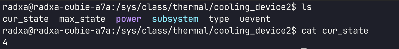

In my case the fan was running at full speed from startup.

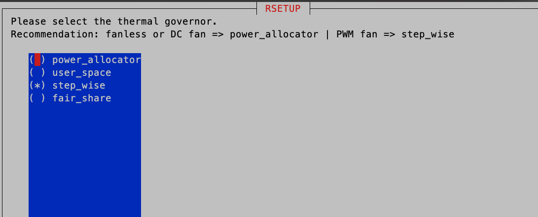

The output of /sys/class/thermal/cooling_device2/cur_state was 4.
Then I opened rsetup > hardware > Thermal Governor and saw it was set to “power_allocator”.
I changed to “step_wise” and the fan stopped.
After some stress testing I see the fan triggers at 69 degrees celsius and then goes full speed at 70 degrees.

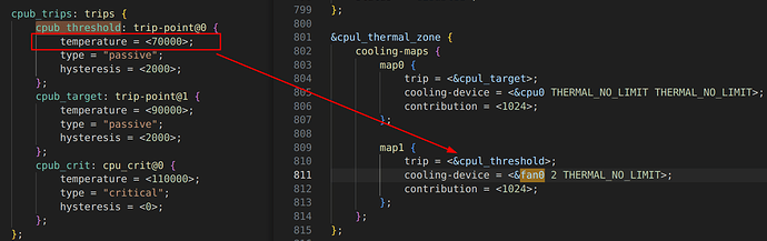

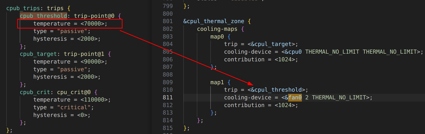

Is there a way to set custom temperatures like e.g start the fan at 65 degrees to level 2 and then increases to 4 when the temperature reaches 70 degrees?
As per the documentation, I can only set a fan level which remains constant. https://docs.radxa.com/en/cubie/a7a/hardware-use/fan#controlling-fan-speed
It is estimated that you need to modify the device tree. The current configuration triggers the PWM fan at 70°C. According to your requirement, you need to add more maps and limit the corresponding fan speed levels.
