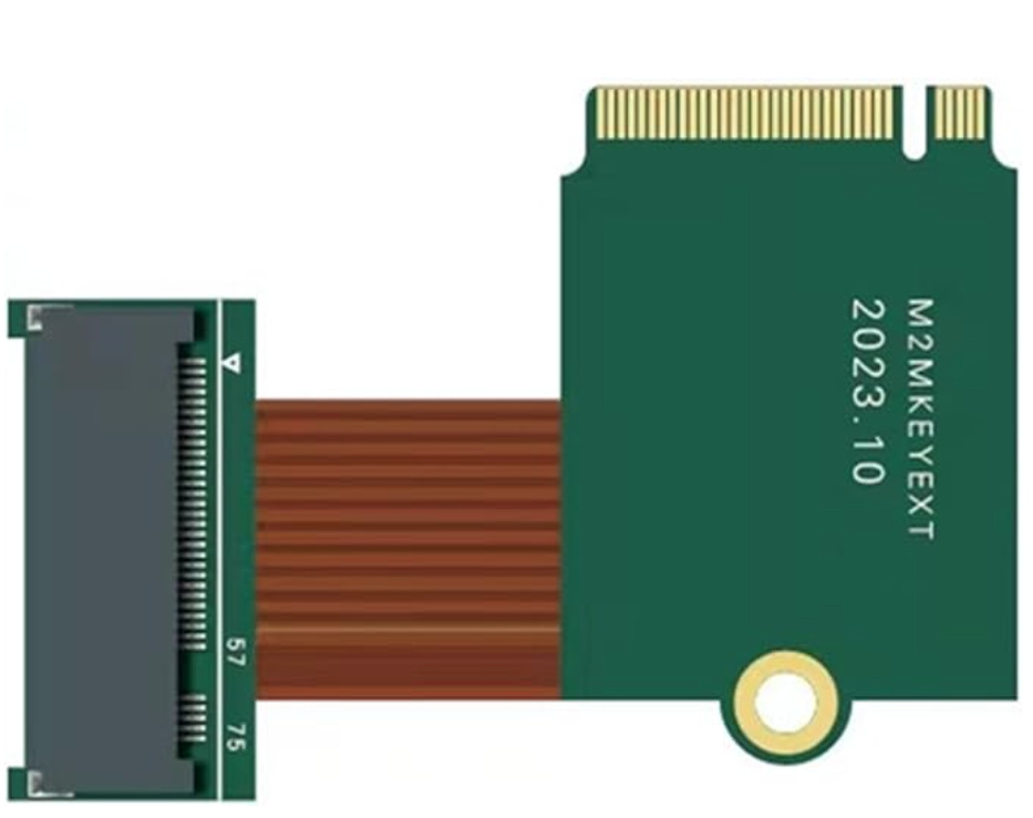

Probably something like this:
But don’t have either x4 or this converter, it should do the trick - plug into 2230 m.2 and put m.2 on flex, there should be more versions with different flex length - choose the one that will fit Your setup.
X4 have intel cpu on bottom so It would not flip nvme to bottom.
For sata - any card with asm1166, likt radxa one: https://radxa.com/products/accessories/m2-to-hexa-sata-adapter/
