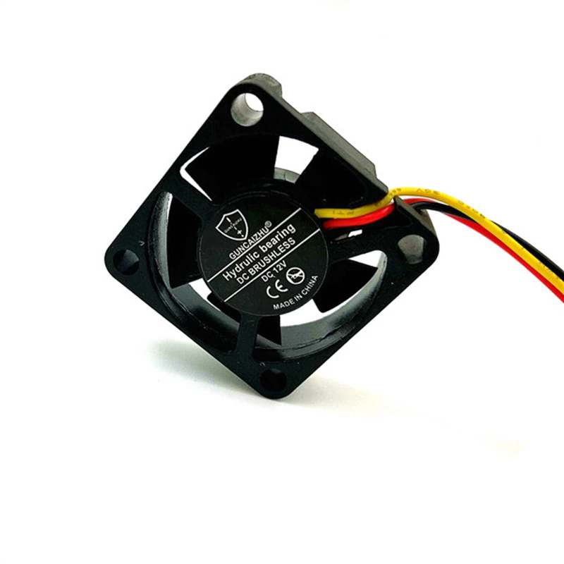

Searching by the dimensions of the fan, voltage (5V) and 3pin connector I found this one:
Do you reckon it would work? If not, what else can I try or where to buy a replacement?
