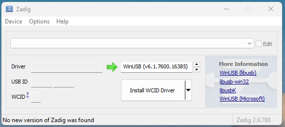

I am having trouble installing the RP2040 driver on X4. RP2040 is not displayed in the list of available devices. BIOS is updated to v004 (X4 Without Onboard eMMC), all other drivers are installed.
What am I doing wrong?
Press the bootsel button to pop-up the RP2040 then install the driver
