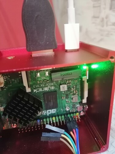

This is what my connection looks like.
I can’t push any further, I’m afraid to break it.
