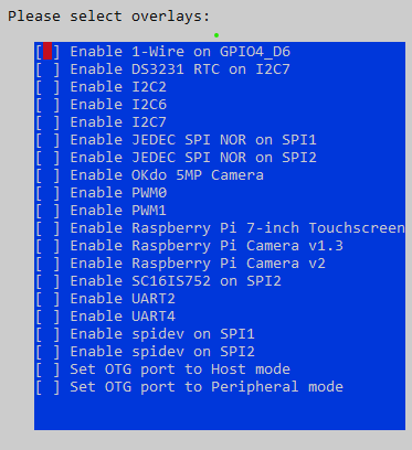

I’ve been looking into overclocking the Rock Pi 4B+ OP1 to use the full 2GHz that it is supposed to have instead of the default 1,8Ghz I’m getting.
Currently stuck at trying to configure rsetup overlays but overclocking or changing frequency simply doesn’t show up.
originally was looking at the wiki but it appears this has long been outdated. So configuration file like hw_intfc.conf have been retired and say to use rsetup instead.
rsetup does allow for device overlay configuration but is missing a cpu frequency overlay.Screenshot%202025-05-19%20154535
In /boot/dtbo can find overlays that look like they could be what i’m looking for but they don’t appear in rsetup overlays:
rk3399-opp-2000.dtbo.disabled
rk3399-opp-2200.dtbo.disabled
Any idea why there are no overlay entries for it or perhaps another approach entirely?
