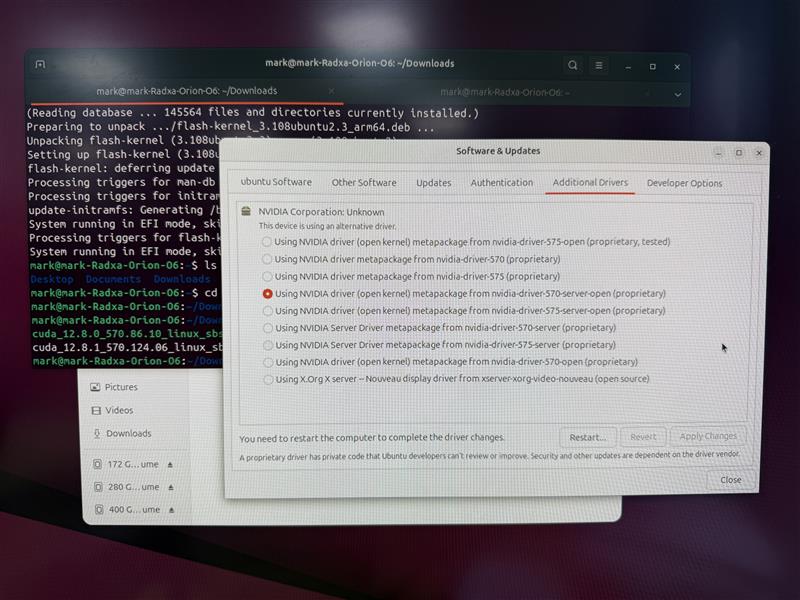

  4. after system installed, sudo apt update, sudo apt upgrade.
  5. install nvidia driver with additional driver install
  6. after reboot, the system still boot into desktop environment.

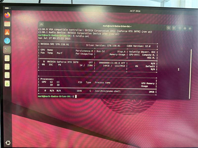

  7. nvidia-smi, congratulation, the Nvidia Graphic card could be recognized.
