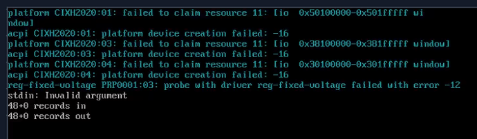

I also tried Ubuntu 25.10, and it booted into the live CD environment after a bit, but was stuck with these messages a while:
Then it was stuck a bit after systemd-update-done.service. Not sure if that’s normal, but it progressed to the graphical installer at least.
