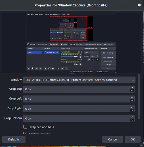

How I got OBS “working”, maybe it will save you googling errors for hours like I did.
and it should open.
I used this device for screen capture, thats as far as I have got.
