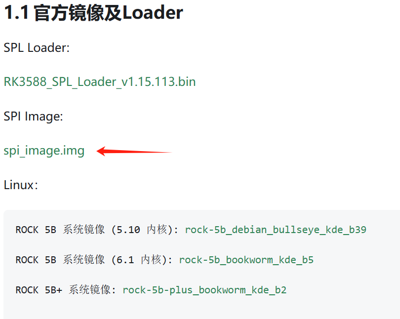

I have a new rock5b with emmc board. I can use RKDevTool program rk3588_spl_loader_v1.15.113.bin and rock-5b-spi-image-gd1cf491-20240523.img successed.
But the board can’t boot. led is blue. below is uart log, Could you help to check what is the problem?

Please ignore this problem , I use wrong img,after use rock-5b_bookworm_kde_b5.output.img the board can run.
If possible, please tell me what spi image is for?
spi_image is used for spi flash
spi_image, actually, is a u-boot.
burn u-boot into spi flash, which can be used to boot other media, e.g. usb boot/NVMe boot, etc.
