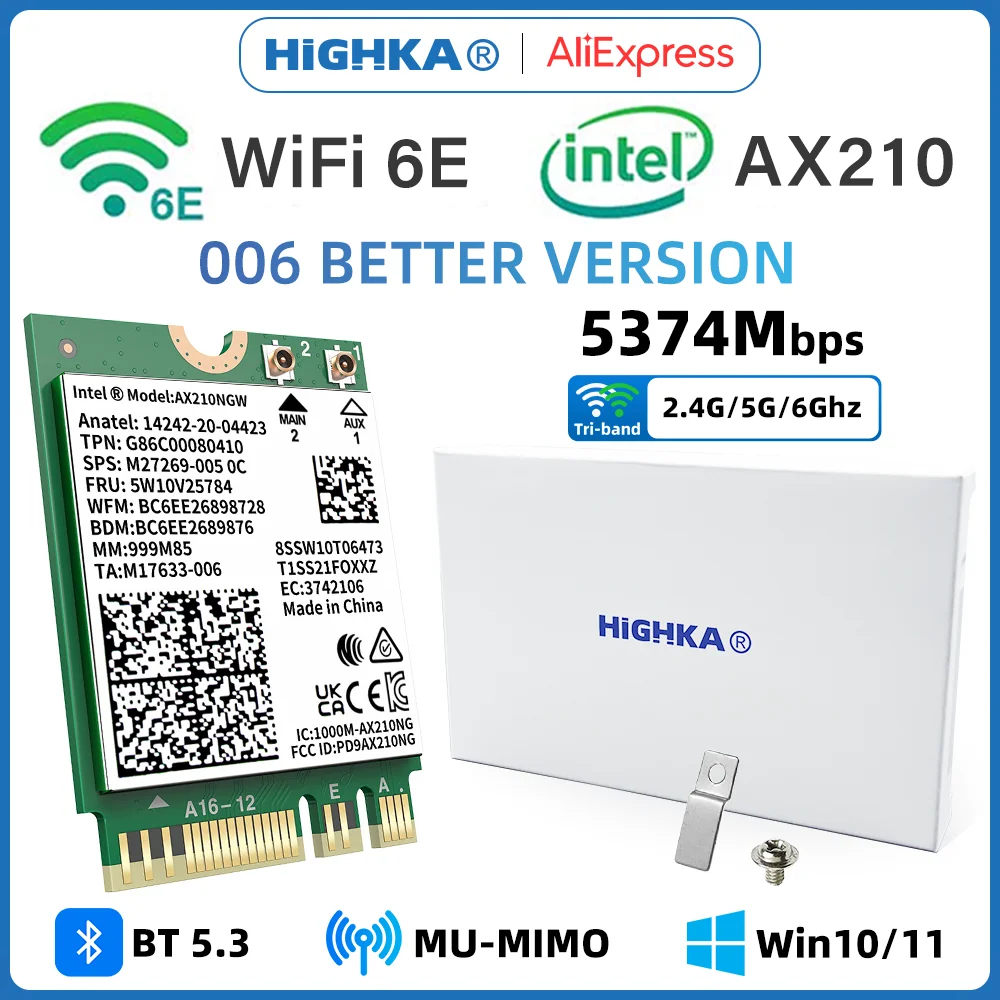

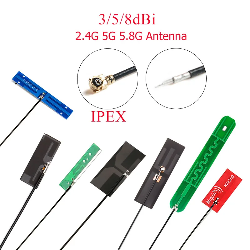

What module are u using in 5A? Also why dont u get some 8dbi antennas for it instead of the stock 2dbi?
AX210NGW WiFi Card WiFi6E 6GHz Tri-Band Network Card Bluetooth 5.3 intel AX210 AX200 Wireless Module for Laptop M.2 NGFF
8dBi IPX IPEX Connector Solder Omni Buletooth Antenna 3dBi IEEE b/g/n WLAN
This doesn’t seem to be about wifi @DarkevilPT.
No wifi involved.
[Desktop]----[switch]----[5A]
