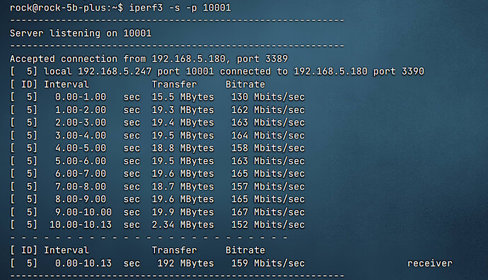

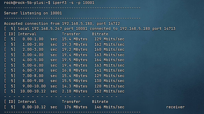

I used iperf3 for the speed test. Onboard WiFi Realtek 8852BE seems to be not very fast.
Under the same conditions, the ROCK5B using an external Realtek 8852BE has about three times the speed.
Currently, I’m using the antenna that came with the radxa. Tomorrow, I’ll try changing the antenna, although I don’t think it will make much of a difference.
