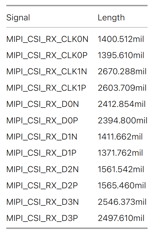

In the datasheet of the CM3 the CSI MIPI trace lengths are given in the table below:
However, when I look at the routing of the CM3 IO board, the above lengths do not match. There is over 25mm between D0 and D1, which seems really large and makes me question the datasheet.
Has anyone else designed a baseboard for the CM3, and how did you match the length of the MIPI-CSI traces?
