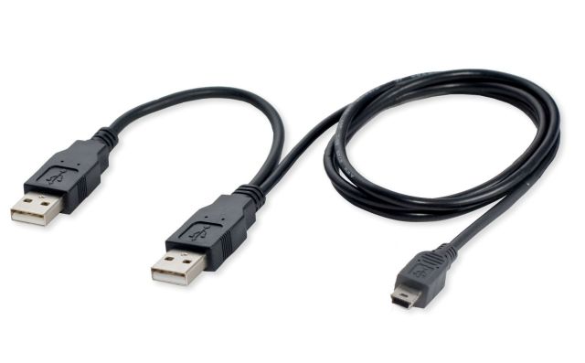

Since RockPi S is usb 2.0 - you are limited to 0.5A, best what i can advice is - use cable like this and connect one of them into the same power source that rock pi s connected to
