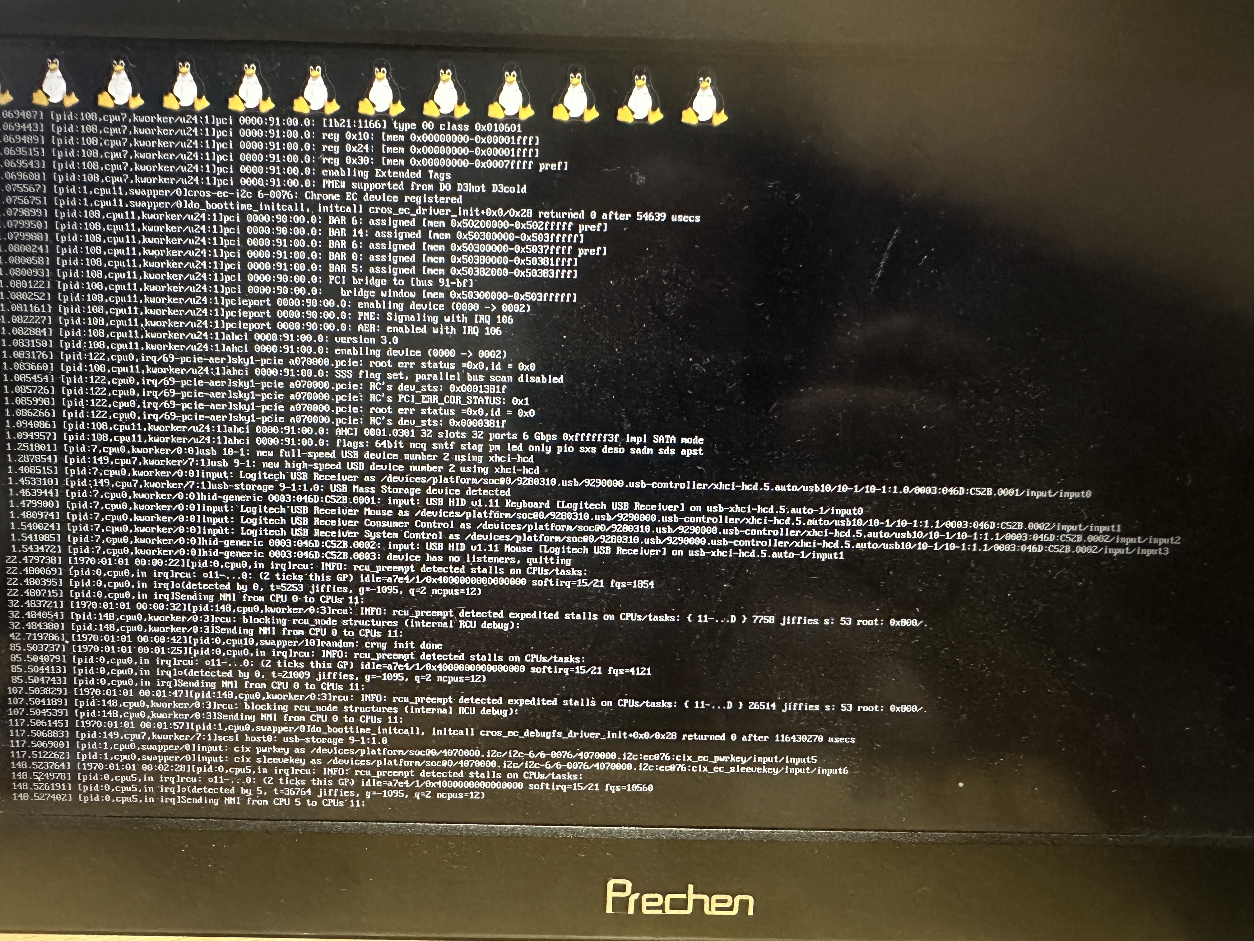

M.2 to SATA expansion card don't work
  • Board: Orion O6 64GB RAM model
  • Firmware: orion-o6-debian12-preinstalled-desktop-b6.img
  • Connection:
    ASM1166 chip connected to M.2 M Key connector
    insert firmware USB stick to USB port
  • Errors: something like:
root err status =0x0, id = 0x0
RC’s dev_sta: 0x0001381f
RC’s PCI_ERR_COR_STATUS: 0x1
  • I can boot the board if use any of below option.
    • remove the M.2 to SATA expansion card
    • use Debian offical ios installed OS with ACPI
