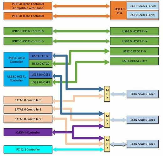

RK3399 (which is in Rockpi 4) and RK3568 (which is in Rockpi 3A) supports usb3 OTG currently in Radxa SBCs. Rockpi 3A is good because it supports 8 GB ram, but unfortunately the pci express slot is still gen 3 with 1 channel. While Rockpi 5 has pci-e gen 3 with 4 channels and up to 16 GB ram. Ideally i would need the mixture of rockpi 3A and 5. :smiley:
pci-e gen 3 4x,16 GB ram and USB3 (or above) OTG would be the dream SBC.
Yeah dunno why but the RK3568 got a sort of client desktop focus which from the specs its obviously not.
RK3588 I think Radxa have got right for what many would envisage its endgoal.
RK3568 I think the formats they got a bit wrong but hey.
If you look at the mux of the rk3568 then it should be PCIe 3.0 x2 which is sort of perfect for that level of SoC.
You could prob have PCIe x4 but the SoC would likely be the bottleneck I did think it was x2 but forgot as the formats they did release I sort of switched off.
If it did have USB 3.0 OTG and it was muxed with the network then with a 5 port m.2 pcie30 x2 sata card it would of been amazing for OMV/TrueNAS but also it can not mount direct a full length m.2 direct.
I think Rockchip got the RK3568 almost right but somewhere along the lines things seem to of got confused but for me RK3588 & RK3588s have good end goals and look like there has been no confusion.
I think they thought the Mali-G52 1-Core-2EE was a full version not the stripped down one of the 2EE ā€œG52Lā€, L is for Little
