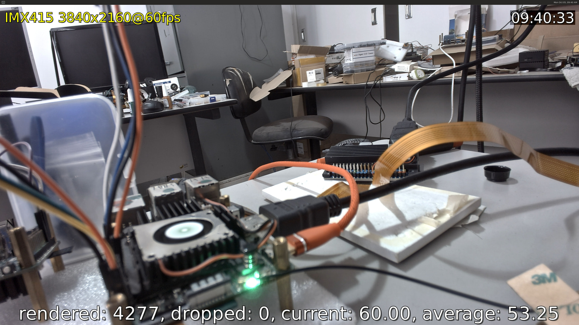

I have 60 fps fully working: Radxa Camera 4K (IMX415) at a real 4K@60 on ROCK 5B – out-of-tree driver, no kernel rebuild
I tested your driver on Rock 5C-lite (8 cores unlocked / missing AVS1 decoder). I get ~55 fps (3840x2160) displayed on screen, but unfortunately the image is dark with the current iqfile (the one which works with 30fps).
I built in-tree kernel module driver, 6.1.43-rk3588-v4l2-cam. Built only the kernel.
Which iqfile and kernel version are you running? Can you please attach the iqfile that runs fine with UHD 60fps?
Update:
I forgot to rename the iqfile to imx415-60fps.
And thanks for your work!
I use:
gst-launch-1.0 -e \
  v4l2src device=/dev/video11 io-mode=dmabuf \
  ! video/x-raw,format=UYVY,width=3840,height=2160,framerate=60/1 \
  ! queue max-size-buffers=2 max-size-bytes=0 max-size-time=0 \
  ! mpph265enc rc-mode=cbr bps=35000000 gop=60 max-pending=4 \
  ! h265parse ! matroskamux ! filesink location=4k60.mkv
This results in true 60 fps on my Rock 5B
I use a slightly different iqfile. Renaming it to correct name solved it in my case. Rock 5C lite has no GPU (or at least a working one, but luckily my GPU works which is good for testing, it oscillates a bit) and some missing encoder but H265 looks fine. CPU% 70~80 (rendering 4k) and 12% if encoding.

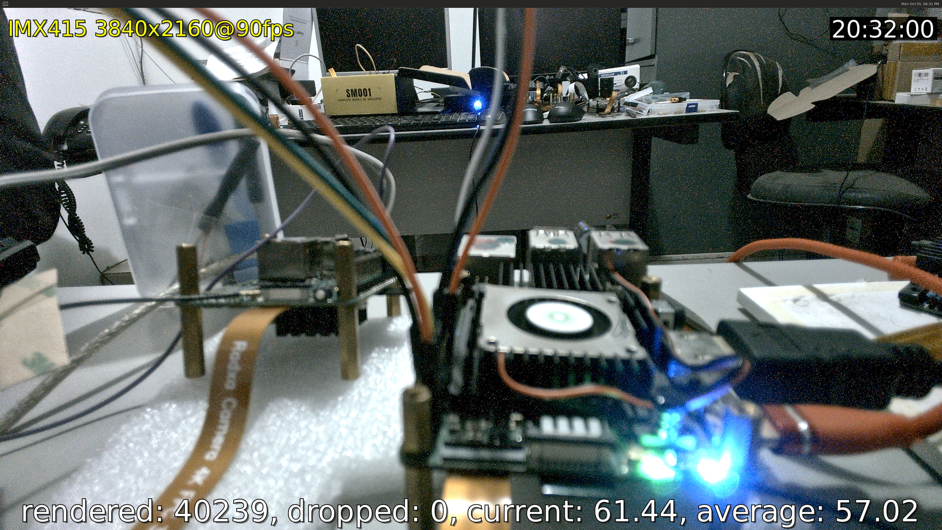

Feedback with my rock 5c-lite setup:
a) It works, most of the times!
b) First time running and grabbing frames gives some csi errors, just like described in 1188 Mhz
v4l2-ctl -d /dev/video11 --set-fmt-video=width=3840,height=2160,pixelformat=NV12 --stream-mmap=4 --stream-skip=500 --stream-count=1 --stream-to=/dev/null
<<<<<<<<<<<<<<<<<<<<<<<<<<<<<<<<<<<<<<<<<<<<<<<<< 63.62 fps, dropped buffers: 17
<<<<<<<<<<<<<<<<<<<<<<<<<<<<<<<<<<<<<<<<<<<<<<<<<<<<<<< 62.68 fps, dropped buffers: 6
<<<<<<<<<<<<<<<<<<<<<<<<<<<<<<<<<<<<<<<<<<<<<<<<<<<<<< 63.46 fps, dropped buffers: 11
<<<<<<<<<<<<<<<<<<<<<<<<<<<<<<<<<<<<<<<<<<<<<<<<<<<<<<<< 63.10 fps, dropped buffers: 6
<<<<<<<<<<<<<<<<<<<<<<<<<<<<<<<<<<<<<<<<<<<<<<<<<<<<<<<< 62.45 fps, dropped buffers: 6
<<<<<<<<<<<<<<<<<<<<<<<<<<<<<<<<<<<<<<<<<<<<<<<<<<<<<<<<< 63.37 fps, dropped buffers: 6
<<<<<<<<<<<<<<<<<<<<<<<<<<<<<<<<<<<<<<<<<<<<<<<<<<<<<<< 62.20 fps, dropped buffers: 6
<<<<<<<^C
c) Second time running (without booting) and grabbing frames:
<<<<<<<<<<<<<<<<<<<<<<<<<<<<<<<<<<<<<<<<<<<<<<<<<<<<<<<<<<<<<<<<<<<<<<<<<<<<<<<<<<<<<<< 90.04 fps, dropped buffers: 5
<<<<<<<<<<<<<<<<<<<<<<<<<<<<<<<<<<<<<<<<<<<<<<<<<<<<<<<<<<<<<<<<<<<<<<<<<<<<<<<<<<<<<<<<<< 90.03 fps
Forum always resize image to 1920x1080 and can’t render faster than this:
d) running third time, csi errors…
Update:
Encoding 90 fps, and image looks normal (better than rendered on screen)
