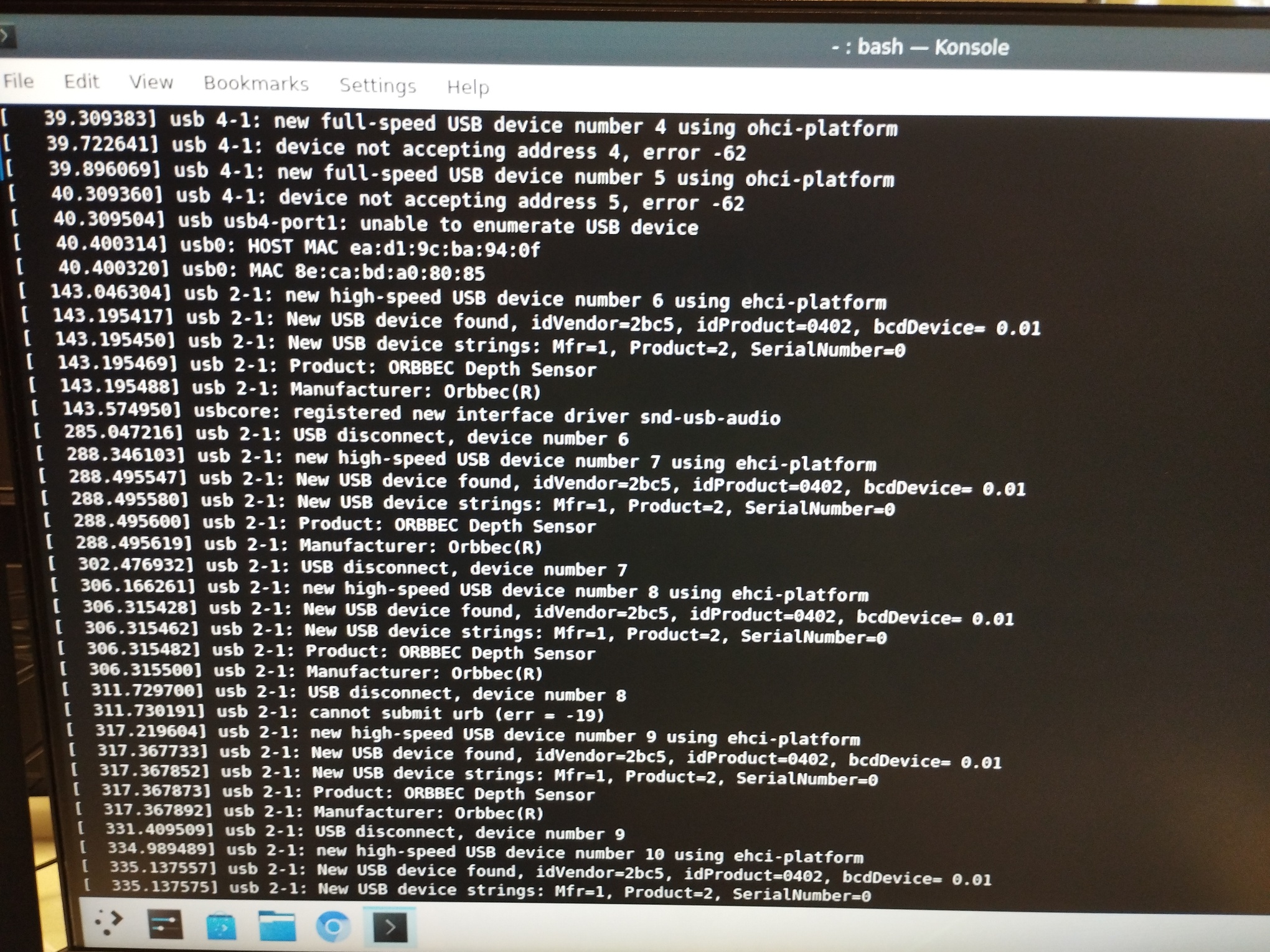

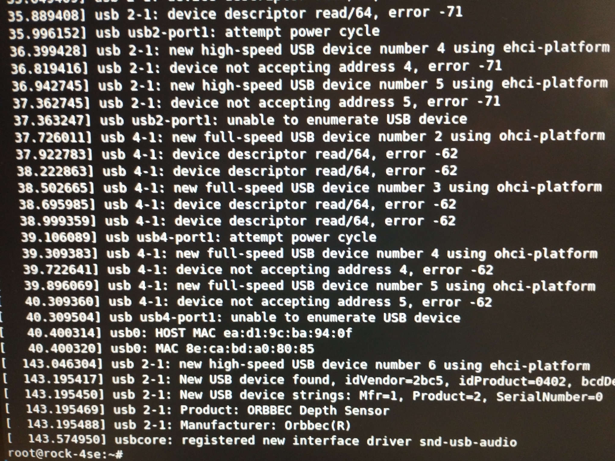

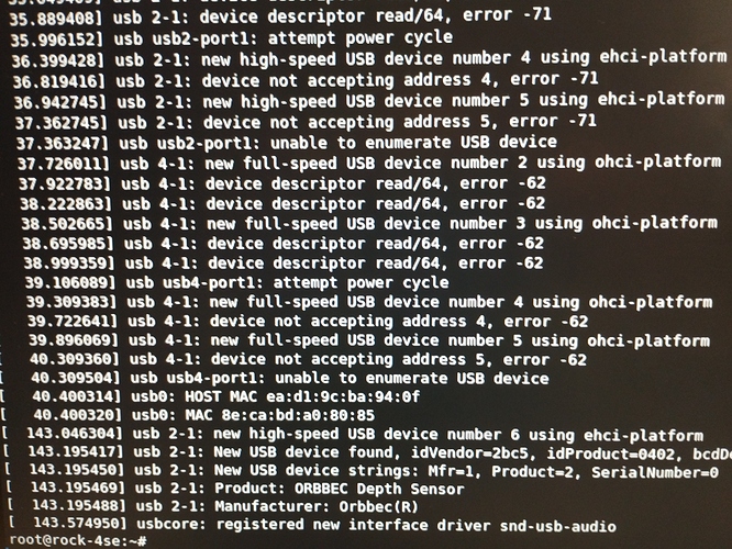

Hi, I tried the rock 4se 5.10 image and it has the same issue. After the device boots, I can plug / remove / plug it many times and it always initializes properly. I suspect maybe the Depth Sensor takes too long to initialize at the beginning when the board is first powered. Is it possible to restart the USB interface / delay starting the USB interface until the system initializes for 20 seconds?
We observe similar behaviour on 4B+ with USB thermal cameras. Sometimes, randomly, when camera is disconnected and reconnected several times, the specific USB port dies and it does not recognize any new device until reboot. The other USB ports continue to work.
We tried using a USB hub but it still doesn’t connect, again after it boots, we can plug / unplug as many times and it would connect, only if it is plugged in during boot that it doesn’t connect.
The device is unplugged and plugged in at ~180 seconds.

[ 64.368813] usb 2-1: new high-speed USB device number 2 using ehci-platform
[ 64.492080] usb 5-1: new low-speed USB device number 2 using xhci-hcd
[ 64.517899] usb 2-1: New USB device found, idVendor=2109, idProduct=2817, bcdDevice= 7.00
[ 64.517910] usb 2-1: New USB device strings: Mfr=1, Product=2, SerialNumber=0
[ 64.517918] usb 2-1: Product: USB2.0 Hub
[ 64.517926] usb 2-1: Manufacturer: VIA Labs, Inc.
[ 64.591968] usb 3-1: new low-speed USB device number 2 using ohci-platform
[ 64.641789] usb 5-1: New USB device found, idVendor=046d, idProduct=c315, bcdDevice=28.00
[ 64.641805] usb 5-1: New USB device strings: Mfr=1, Product=2, SerialNumber=0
[ 64.641813] usb 5-1: Product: Logitech USB Keyboard
[ 64.641821] usb 5-1: Manufacturer: Logitech
[ 64.664950] input: Logitech Logitech USB Keyboard as /devices/platform/usb@fe900000/fe900000.usb/xhci-hcd.3.auto/usb5/5-1/5-1:1.0/0003:046D:C315.0001/input/input0
[ 64.719476] hid-generic 0003:046D:C315.0001: input,hidraw0: USB HID v1.10 Keyboard [Logitech Logitech USB Keyboard] on usb-xhci-hcd.3.auto-1/input0
[ 64.814021] usb 3-1: New USB device found, idVendor=04b3, idProduct=310c, bcdDevice= 2.00
[ 64.814032] usb 3-1: New USB device strings: Mfr=0, Product=2, SerialNumber=0
[ 64.814040] usb 3-1: Product: USB Optical Mouse
[ 64.821906] input: USB Optical Mouse as /devices/platform/fe3a0000.usb/usb3/3-1/3-1:1.0/0003:04B3:310C.0002/input/input1
[ 64.878872] hid-generic 0003:04B3:310C.0002: input,hidraw1: USB HID v1.11 Mouse [USB Optical Mouse] on usb-fe3a0000.usb-1/input0
[ 65.225434] usb 2-1.2: new high-speed USB device number 3 using ehci-platform
[ 70.508789] usb 2-1.2: device descriptor read/64, error -110
[ 80.968796] usb 2-1.2: device descriptor read/64, error -71
[ 81.198676] usb 2-1.2: new high-speed USB device number 4 using ehci-platform
[ 81.331998] usb 2-1.2: device descriptor read/64, error -71
[ 81.572009] usb 2-1.2: device descriptor read/64, error -71
[ 81.678964] usb 2-1-port2: attempt power cycle
[ 83.191991] usb 2-1.2: new high-speed USB device number 5 using ehci-platform
[ 83.611992] usb 2-1.2: device not accepting address 5, error -71
[ 83.735301] usb 2-1.2: new high-speed USB device number 6 using ehci-platform
[ 84.155325] usb 2-1.2: device not accepting address 6, error -71
[ 84.156580] usb 2-1-port2: unable to enumerate USB device
[ 84.282003] usb 2-1.3: new high-speed USB device number 7 using ehci-platform
[ 84.429615] usb 2-1.3: New USB device found, idVendor=1a40, idProduct=0101, bcdDevice= 1.11
[ 84.429641] usb 2-1.3: New USB device strings: Mfr=0, Product=1, SerialNumber=0
[ 84.429660] usb 2-1.3: Product: USB 2.0 Hub
[ 84.508658] usb 2-1.5: new high-speed USB device number 8 using ehci-platform
[ 84.607577] usb 2-1.5: New USB device found, idVendor=2109, idProduct=8817, bcdDevice= 0.01
[ 84.607604] usb 2-1.5: New USB device strings: Mfr=1, Product=2, SerialNumber=3
[ 84.607623] usb 2-1.5: Product: USB Billboard Device
[ 84.607641] usb 2-1.5: Manufacturer: VIA Labs, Inc.
[ 84.607658] usb 2-1.5: SerialNumber: 0000000000000001
[ 87.791841] usb0: HOST MAC c6:90:fe:cd:dd:cc
[ 87.791854] usb0: MAC 4e:b7:b1:49:32:56
[ 87.793843] udc fe800000.usb: failed to start radxa-otgutils: -19
[ 178.074853] usb 2-1: USB disconnect, device number 2
[ 178.074869] usb 2-1.3: USB disconnect, device number 7
[ 178.081052] usb 2-1.5: USB disconnect, device number 8
[ 179.527631] usb 2-1: new high-speed USB device number 9 using ehci-platform
[ 179.676947] usb 2-1: New USB device found, idVendor=2109, idProduct=2817, bcdDevice= 7.00
[ 179.676962] usb 2-1: New USB device strings: Mfr=1, Product=2, SerialNumber=0
[ 179.676967] usb 2-1: Product: USB2.0 Hub
[ 179.676973] usb 2-1: Manufacturer: VIA Labs, Inc.
[ 180.394236] usb 2-1.2: new high-speed USB device number 10 using ehci-platform
[ 180.543455] usb 2-1.2: New USB device found, idVendor=2bc5, idProduct=0402, bcdDevice= 0.01
[ 180.543470] usb 2-1.2: New USB device strings: Mfr=1, Product=2, SerialNumber=0
[ 180.543476] usb 2-1.2: Product: ORBBEC Depth Sensor
[ 180.543481] usb 2-1.2: Manufacturer: Orbbec®
[ 180.694043] usb 2-1.3: new high-speed USB device number 11 using ehci-platform
[ 180.775439] usbcore: registered new interface driver snd-usb-audio
[ 180.841765] usb 2-1.3: New USB device found, idVendor=1a40, idProduct=0101, bcdDevice= 1.11
[ 180.841782] usb 2-1.3: New USB device strings: Mfr=0, Product=1, SerialNumber=0
[ 180.841788] usb 2-1.3: Product: USB 2.0 Hub
[ 180.917346] usb 2-1.5: new high-speed USB device number 12 using ehci-platform
[ 181.016578] usb 2-1.5: New USB device found, idVendor=2109, idProduct=8817, bcdDevice= 0.01
[ 181.016591] usb 2-1.5: New USB device strings: Mfr=1, Product=2, SerialNumber=3
[ 181.016597] usb 2-1.5: Product: USB Billboard Device
[ 181.016603] usb 2-1.5: Manufacturer: VIA Labs, Inc.
[ 181.016608] usb 2-1.5: SerialNumber: 0000000000000001
