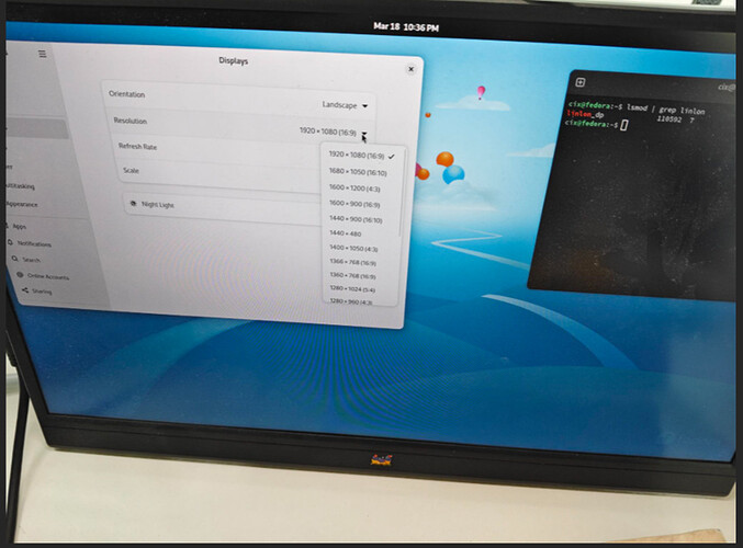

  • Verify
    reboot system
    If multiple resolutions can be seen through the settings ->display, it can be considered that dpu enable is successful
    lsmod command can see that linlon_dp.ko is loaded and also confirm that dpu enable is successful
