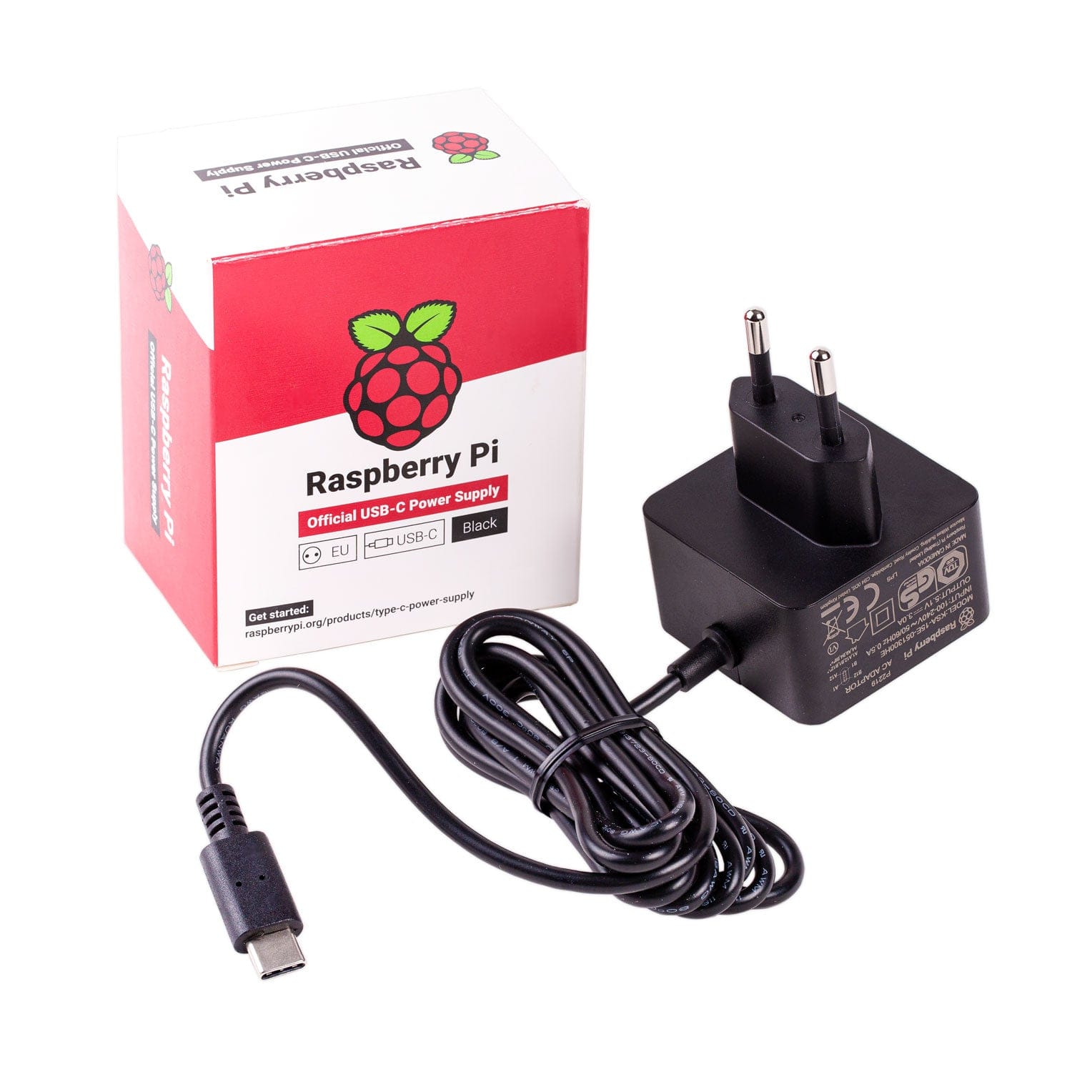

I believe the key for this is 3A it also seems like that Rasp Pi 4B plug works perfectly fine and its just 5V 3A but who tested those didnt had wifi module on so its on its limit but does work.
Myself personally I am going to try this one:
https://a.aliexpress.com/_mLEWIM0
