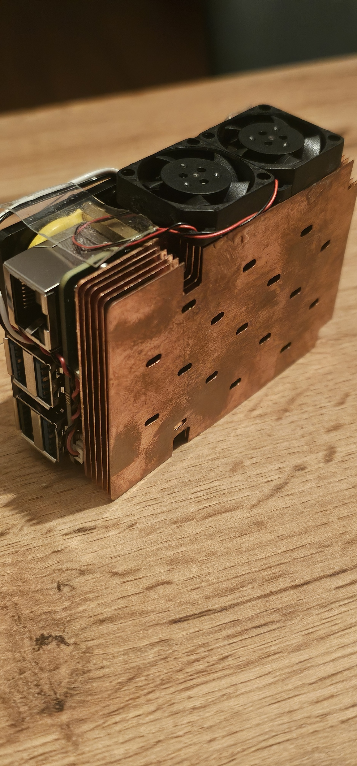

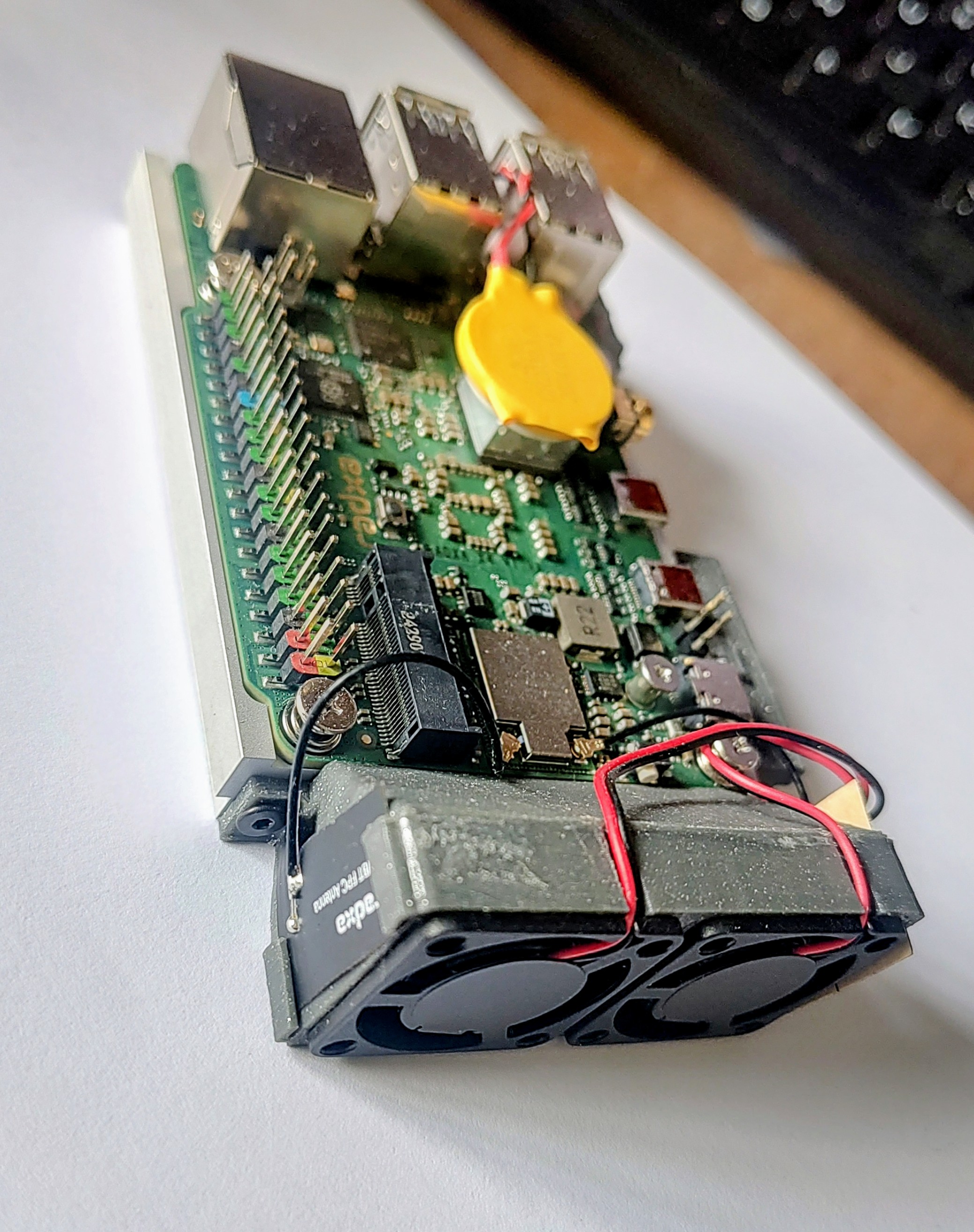

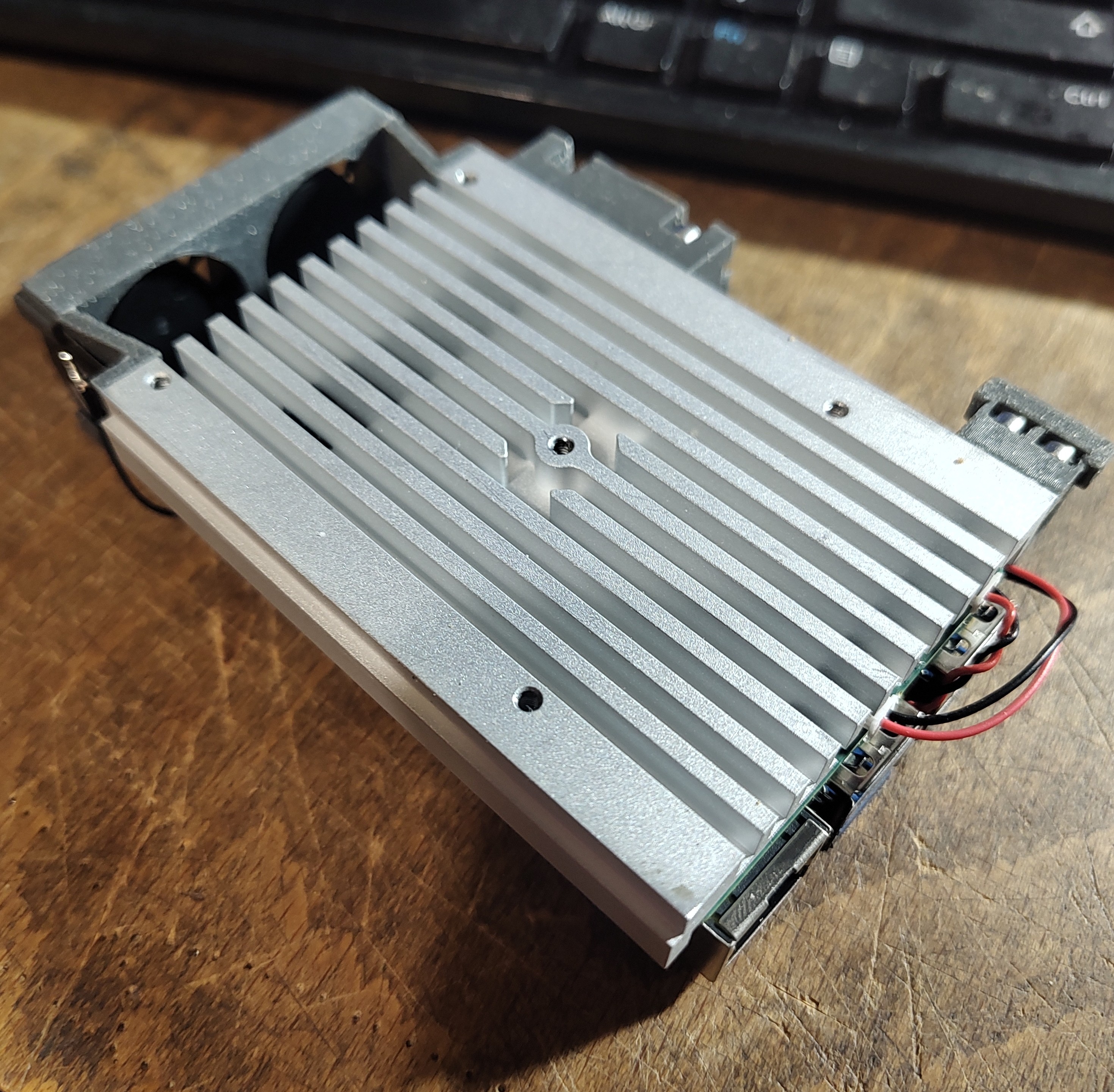

None of the heatsinks available would fit into the space I have (32mm height) so I have made my own.

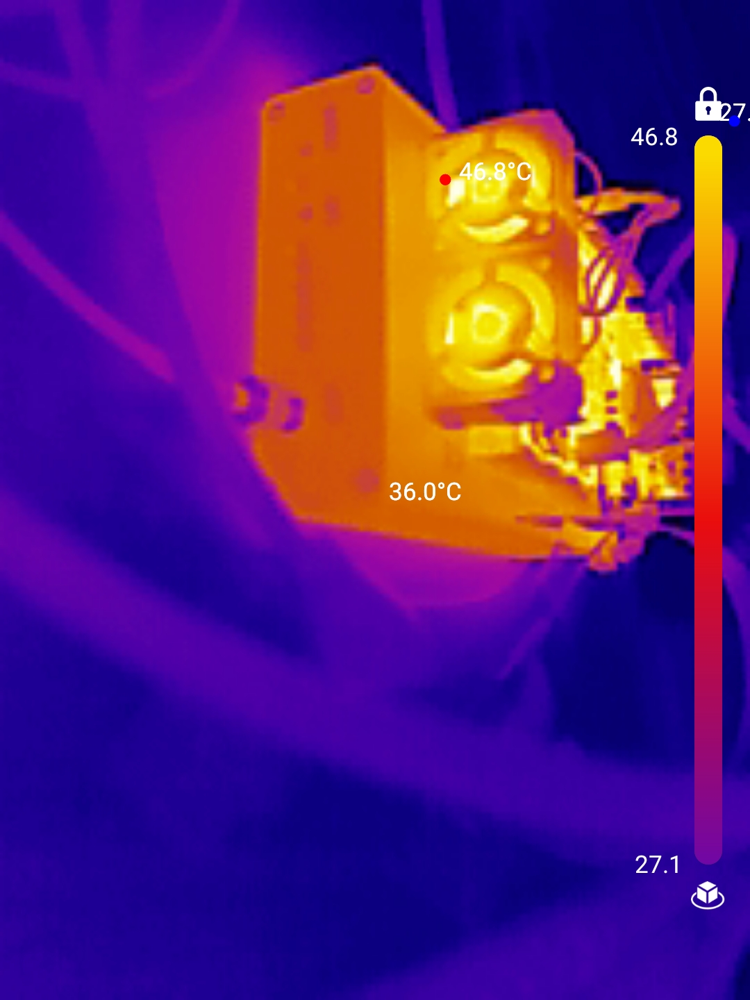

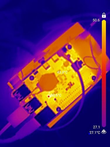

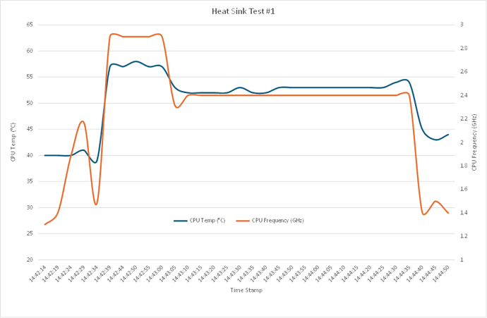

I must have been sitting on the Radxa X4 now for a couple of months, and though I have designed and had made the heatsink I haven’t fired her up until today. After an initial panic because of a black screen, thread on black screen indicated HDMI lead could be an issue, so swapped it and installed Ubuntu 24. Initial problem with fans not running so while Ubuntu was loading the heatsink got warm not excessive but enough to know about it. I moved to powering off the GPIO +5V supply and heatsink temp plummeted. Ran sysbench prime number calculation using 4 cores for 120 seconds, ambient 27 degrees, CPU starting temp 40 degrees, peaked at 57 degrees in first 20 seconds (2.9 GHz CPU clock) then levelled off at 53 degrees for next 100 seconds (2.4 GHz CPU clock) then dropped back to 40 degrees (1.3 GHz CPU clock). It isn’t in its case yet, but I think heat sink is working fine. The two fans draw through the heat sink, there will be a third fan drawing air through the rest of the case.

I agree copper is better than aluminum - but aluminum is much cheaper than copper when it comes to manufacture and in my case I appear to have plenty in hand. This is the graph of temps across the 120 second test.

Lol - no that would be a luxury, these are in small aluminum cases with an overall height of 32 mm - internal height is 28mm, so all a bit tight, which is why I had to go down the route of my own heatsink. I did look at modifying existing designs but that wasn’t cost effective.
