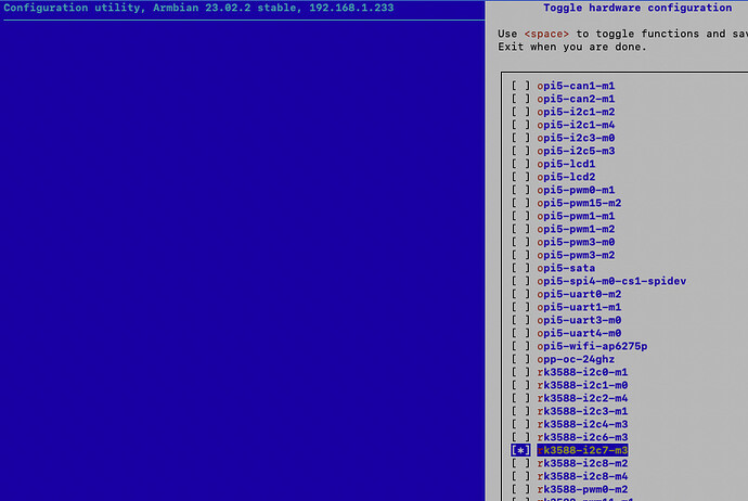

Hardware configuration scriptable instead of armbian-config?
Is there a scriptable way to modify hardware configuration? I want to turn on rk3588-12c7-m3 with a bash script. Not sure what file to modify?

Simple answer is overlays applied via /boot/armbianEnv.txt
Watch the change made by armbian-config then you can script it
See here
https://docs.armbian.com/User-Guide_Armbian_overlays/#armbianenvtxt-entries-reference
